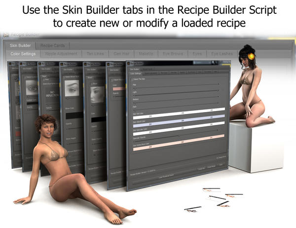

This is an Add-On script for Skin Builder, that will let you save and share the settings you select to create your custom skins.
You will use the script called Recipe Builder instead of the separate scripts that came with Skin Builder to create your skins.
The top tabs of the script are divided into to two groups; Skin Builder and Recipe Cards. The first tab, Skin Builder, has sub-tabs that are basically the various scripts that are in Skin Builder. This is so that all of the available settings are in one place. By making all of your selections from one place in Recipe Builder, you will be able to save those settings to a data file that are called Recipe Cards.

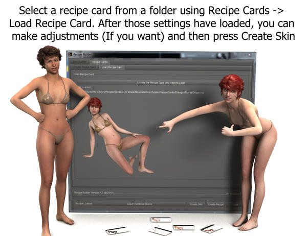

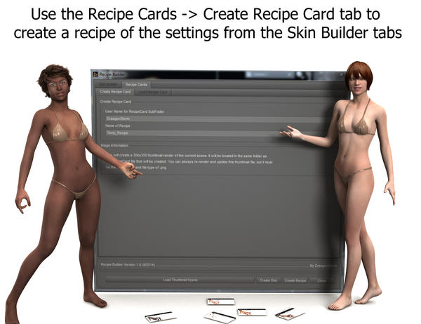

The Second tab, Recipe Cards have two tabs; Create Recipe Card and Load Recipe Card. After you have made the settings under the Skin Builder tab, you can save those settings using the Create Recipe Card. This will create a data card with all of your settings that can be read in from the either the Load Recipe Card tab, or the script Recipe Loader. (Note: the Recipe Loader script will also be added to Skin Builder product as an update).
Using the Recipe Builder or Recipe Loader script, you can load saved Recipe Cards that you created or obtained from someone else. You can apply the settings to Genesis or G2F from either script.
After you load a Recipe, the settings are available to you to make any adjustments you want before you either, Create the Skin or Save/Update a Recipe Card.
