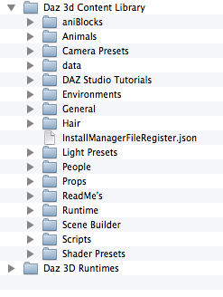

Example i have architools its a plugin do i direct the install to the carrara app folder or the application itself?
in my Daz 3d Content Library is a folder named runtimes, do i direct the install to runtimes or just the enclosing folder? hopefully i will muddle my way thru this any help greatly appreciate

    My question is this how in the DIM do i direct the installations to one folder say my Daz 3d Content Library? do runtimes get installed there also? do i have to direct each individual item with a path to that folder?
    You already have that path set up ( Daz 3d Content Library) inside DIM as shown in your second image. DIM will install ALL content to that path, including Poser Content which needs a Runtime structure, you do not need to add any other paths.

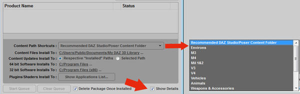

    Go into DIM's settings and set up the paths for ALL of your DAZ Software, unless you don't want DIM to install to them. This means that you can set Carrara 7, 8, and 8.5, if you have them all installed, and it will (so I've been told) install all "Carrara-Specific" plugins and content to each of them.
    Adding custom installation locations (folder) is easy. You can add them under settings.
    Now when using the DIM, just always have "Show Details" (bottom arrow) checked. This brings up the drop-down of all of your folders whic you may install to (upper arrow in the image, leads to a second screenshot showing the upper half of my drop-down)
    Now you can review your list of stuff that can be downloaded and/or installed, and use the drop-down to select where they get installed to.
    Also notice the third line down in my image below.
    Having "Content Updates Install To:" set to "Respective Installed Paths" means that, I can select all updates and start the queue, knowing that updates for things that are in my V4 path will go to the V4 path, while updates for stuff in Environs will go to Environs, and so on. Pretty slick!
    938 x 296 - 156K

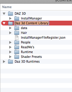

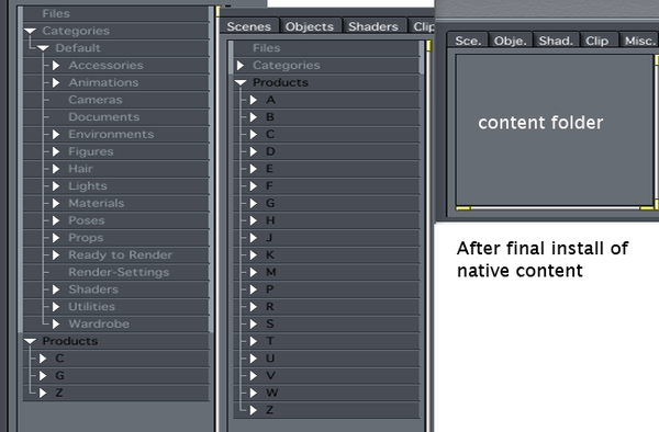

    I have installed carrara correctly and installed native content one by one and the problem begins, nothing was installed in the browser content folder and in smart content catagories the folders were installed but nothing in them. cant find any genesis figures in smart content. i have apps set coreectly and content saved to one folder named Daz 3d Content Library and i dont think its all there. also when i open something from browser i have to find the runtime for each item. i havent used content at all but would like to use it for some ideas and for general knowledge. any suggestions? thanx
    648 x 426 - 59K
    241 x 307 - 20K
    Post edited by dot_bat on
    You have a folder called 'DAZ 3D Content Library' what did you install into there, and how did you install it? Did you use DIM?
    Did you install Genesis Starter Essentials and Genesis Starter Essentials 2 as well?
    Can you find Genesis in the People folder, and Genesis 2 as well?
    I have nod idea how to reimport Metadata in Carrara, or even if it can be done. You can do it inside DAZ Studio of course

    That is your Smart Content tab you are showing? Can you see Genesis under the library in the ordinary Content tab? If so, it must be installed correctly. As I say, I have no idea how to get Smart Content to work in Carrara, I don't use it anyway, but I installed PostgreSQL so it wont work with that.

    If you're on a Windows Machine (I haven't a clue how MacOS works):
    Go to Local Disc > Program Files (x86) > DAZ 3D > DAZDIM1 and open the folder "cms" and run that installer.
    This installs the DAZ Content Management Service (Vatentia), which is required to use Smart Content.
    Do that while Carrara is Not running.
    Do Not update CMS to PostGRE as that is for the latest DS, but doesn't work on Carrara 8.5
    Your 'custom' setup of folders is so incredibly similar (almost down-right exact) as the default where DIM would have put everything, I'm not sure why you didn't just opt to let it use its own default, but... to each his own.
    Now
    Native Content doesn't place anything into the Content nor the Smart Content tabs.
    Content Tab is a place to organize Poser Runtimes and DAZ Studio Libraries only.

  • DartanbeckDartanbeck Posts: 22,154
    dot_bat said:
    i used the dim to install everything,i installed all content into daz 3d content library and the carrara app to my app folder and directed native content to the folder where carrara app resides. attached is my people folder, folders no content. why did it install folders and no content. i must be very thick for not getting this. i just dont want to install anything to my os volume to keep it light. it seems once you go off the beaten path you get problems
    The valentina cms is required to be installed for the Smart Content to work.
    (See above post to install Valentina CMS)
    Please note that there isn't any Genesis "Content" in any of the Carrara Native Content.
    Carrara 8.5 Native Content is a supplemental installation which adds several Carrara shader sets to your Shaders tab for use with Genesis.
    Genesis Starter content is found in a product called something like Genesis Starter Essentials and is a separate download for DIM.
    It should be installed to the same place as your DAZ Library (My DAZ 3D Library, by default)
    Other products for Genesis also get installed to the DAZ Library.
    In fact, if you're only using Genesis and Carrara, you don't have to tell DIM where to put anything. Just leave it at "Default Location" and it will put Carrara stuff in the Carrara installation path, and Genesis in the DAZ Studio Library.

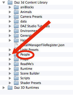

    To see if you have anything installed for Genesis, here is a copy of your own screen shot from the first post.
    I've drawn a circle around the People folder.
    The arrow points to the little triangle to the left. Click that.
    The People library selection will open to reveal Genesis, Genesis 2 Female, and Genesis 2 Male, depending upon what you have installed.
    Click on Genesis to reveal a single file: Genesis (the default Genesis figure)
    Open Genesis to see all content that you've purchased for Genesis, characters, clothing, hair, poses, etc.,
    Use the Content tab to load Genesis into a scene.
    To properly use the Smart Content tab as it was meant to be used:
    Once Genesis is loaded into a scene, click on Genesis (the line of hierarchy just above 'Actor') and then go to the Smart Content tab and wait for the database to fill. This will likely speed up with use - I'm not sure, as I don't use Smart Content.
    It is meant to be Smart Content by showing you what content you own that can be loaded onto whatever you have selected.
    So if you have nothing selected in a scene, or something that is not Genesis, there should be nothing in the Smart Content tab.
    As your screen shots show, Smart Content tab does have a hierarchy of locations that you may browse manually.
    But that is not the intention of how this tab is to work. You shouldn't use Smart Content to "locate" content manually. It's much easier to do that in the "Content" tab, using the organizational system of the DAZ Library.
    For Genesis and all of its accessories, "People" > "Genesis" is where to look - nowhere else. Most the other folders are a disorganization created via published artists making new folders in that path. However:

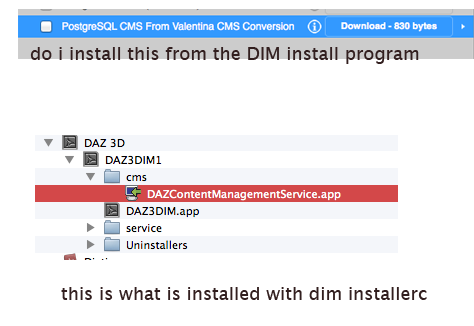

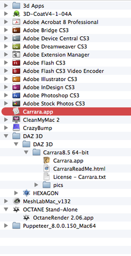

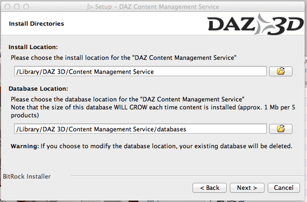

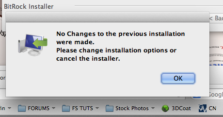

    hi dart, here is what i get when trying to install DAZ Content Management Service (Vatentia.see attached) apparently its there somewhere tho i never installed it, or should i install to a new location?. i dont install any extraneous material to my os volume because i keep it small and dont want it to grow as the install manager says it will grow bt 1.5 MB per item and i want all content in one place. and what is the carrara install that i have hilited? Im going to reinstall everything again if i can get this other management thing installed. thanx for help. also screen shot of smart content, folders installed but greyed out and nothing in folders
    474 x 326 - 27K
    151 x 865 - 26K
    460 x 241 - 49K
    273 x 534 - 58K
    657 x 432 - 73K

    Yeah,
    I think that everything should be greyed out if you don't have a Genesis figure (or similar meta-data-using figure or prop) selected in a scene.
    I don't know why you have a separate Carrara.app
    Hmmmm....
    Okay, so you know now that you have Vantentina CMS... good.
    Now just make sure that you have Genesis installed, which requires: Genesis Starter Essentials
    Genesis Starter Essentials contains all of the free base figures of Genesis and some extra goodies to dress them up with. You need this in order to have Genesis on your system.
    If you don't have it, check your account.

  • dot_batdot_bat Posts: 373
    Thanx everybody! I got everything to work and placed where i wanted. It was the valentina file i needed. worked great. Very handy this DIM. Thanx again
