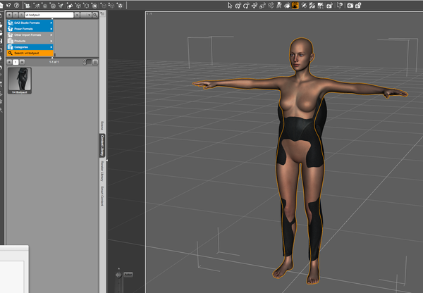

    Hi, guys. Thanks for answering. My problem seems very specific to the Victoria 4.2 Bodysuit. Any other old clothing item I use, the Auto-Fit window comes right up and I'm able to fit it to my Gen2f.
    When I try to use the Victoria 4.2 Bodysuit the Auto-Fit option does not come up and the suit just wraps around the figure like the attached image. I uninstalled and re-installed the bodysuit in case it might be corrupted, but still no luck.

    You have a completely different icon to me for loading the V4 bodysuit, mine is Grey in colour?
    Perhaps you need to update it? If you can see the V4 clone option in the Autofit drop down for other clothing types, then it is installed correctly I would think.

  • Richard HaseltineRichard Haseltine Posts: 111,367
    Is this what you are using http://www.daz3d.com/victoria-4-dynamic-bodysuit ? Dynamics can't be converted, though you may be able to line the figure up with the suit (without fitting it) and then do an animated drape to your pose in frame 30.
    You are using the item I linked - or another dynamic bodysuit. The rig figure is the helper skeleton that allows the item to roughly follow the figure before draping. As I recall the item you link will be found under Poser Formats>content library name>Figures>Victoria 4 Clothing, but you can check the readme to be sure.

    edited August 2014
    Just for future reference, the bodysuit you were trying to use is V4Bodysuit without spaces. The one in your image was the dynamic version Richard linked as the conforming suit doesn't have lines running down it in the 'corset' area, but the dynamic version does.
