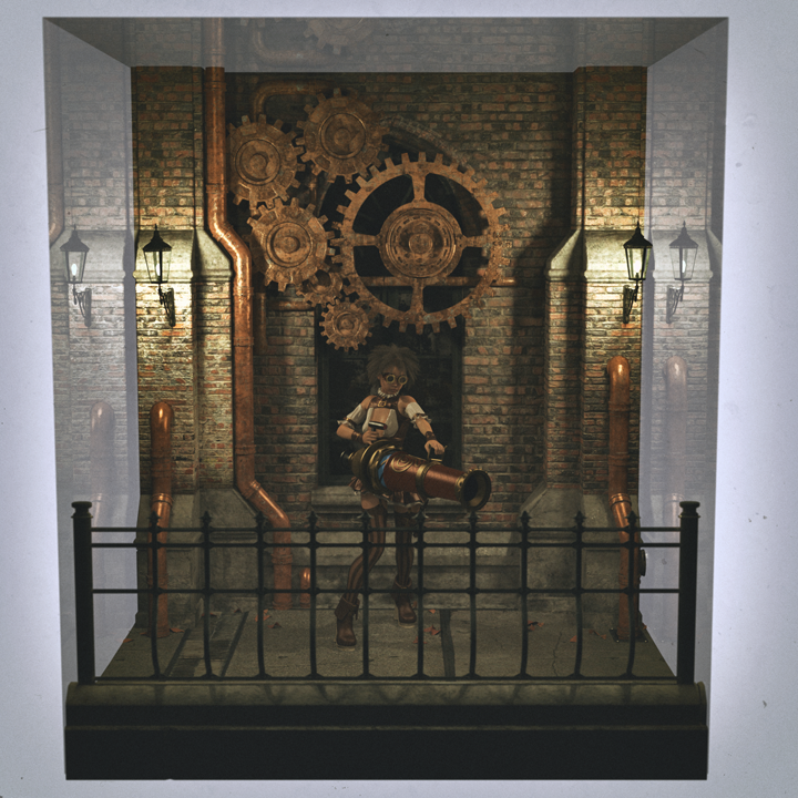

    I've been playing with the kit and it really does make working with section planes much easier. Having the six planes (sides of the cube) all setup for you is great. Having corresponding geometry that you can actually see in the scene is also a huge help.
    It's fun to try and find good places to drop the kit into an environment and make a quick little display. The reflections in the glass of the included case add a lot of interest:
    - Greg

    That is SO COOL, Greg! I love it! :D I'm so glad you're having fun with the Iray Stand Kit! What an awesome scene!
