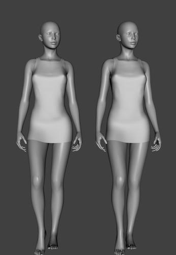

  • BejaymacBejaymac Posts: 2,009
    The attached pic shows what appears to be the same character morphs, but it isn't, one of them is Genesis using my Jenni morph, the other is Jenni as a base figure.
    So it is possible to do what you asked, but it's not recommended, the rig needs reworked and nothing will fit as you've changed the base shape, even the morphs don't look too good.
    Now I'm using an older version of 4.6 so things might have changed in the newer versions, but if you go "Edit > Object > Geometry" you should find an option called "Update Base Geometry", this will open a small window with two options, "Update Vertex Positions" and "Update Full Geometry", the first one morphs the mesh, the second replaces it for the new mesh, once you make your choice it's a case of find the mesh and set the import settings.
    Now you need to adjust the rig to work with the new shape, if you used option one from "update base geometry" then you can get away with using "adjust rig to shape", otherwise you will have to do it manually, btw no need for ERC freeze as your not working on a morph.
    Next you can either save it or change the label you see in the scene tab and then save it, to save use "File > Save as > Support Asset > Figure/Prop Asset", select where to save the DUF and name it, in the Figure/Props Asset window that opens change the Vendor name from DAZ 3D to your own before hitting Accept, otherwise you'll overwrite Genesis.
    Now you just have the problem of getting clothing to fit.

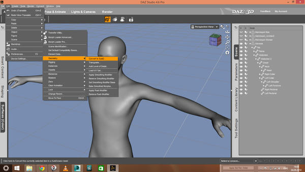

  • edited September 2014
    Thank you Bejaymac
    But I did't find “Update Base Geometry” option in my DS 4.6 (Pro version)
    1600 x 900 - 534K
    Post edited by makaronik_736de7a923 on
  • Richard HaseltineRichard Haseltine Posts: 111,701
    You don't appear to have anything selected.
  • edited December 1969
    Everything stay the same if I choose something
    Try reloading your layout - Window>Workspace>Select Layout.
    I tried all the layouts.
    Which version of DAZ Studio are you using - Help>About DAZ Studio?
    4.6.0.18 Pro (64bit)
    I've checked the change logs for DS and it looks like your version is to old to have that feature.
