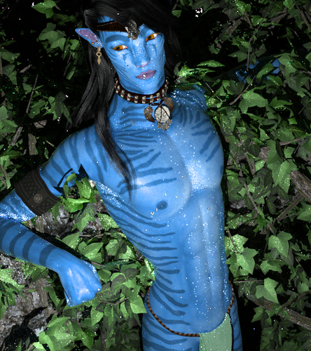

I have been working with Reality 2 through DAZ Studio for a few months or so (though I've only used it for a few renders), and recently came across a problem I have never experienced before. Most of the picture is fine, but there are unexplained white spots all over my render! But oddly, somewhat patterned. I couldn't find anything on the Reality forum itself about this, but are there any users here who could help?
Here is my render, to show the problem. These are really bright dots!
884 x 995 - 2M
    These look like 'fireflies' and they are a common occurrence in Luxrender
    You could have a look here on the Luxrender forum : http://www.luxrender.net/wiki/New_User_Tips_and_Tricks
    Hi.
    Actually they are not common at all, at least not with the current version of Reality and LuxRender.
  • pcicconepciccone Posts: 661
    What version of Reality and LuxRender are you using?
