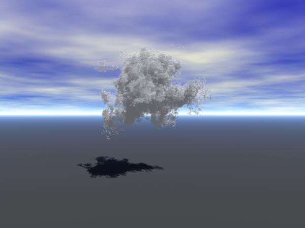

    As I said in another thread, I like rocks as well for making clouds
    The stones are a clever solution, Chohole. I have used this trick as well but I find it has its limits unfortunately. For example, I once modeled a funnel cloud for a tornado scene. When I brought the tubular shaped object into Bryce and applied a volumetric material I ran into some serious issues. Apparently volumetric "layers" are built from the inside outward, not the other way around, so the farther away a point may be from the center of the object the thinner the volumetric material will appear there. So on some level volumetric materials really only want to be applied to simple primitive shapes like spheres and cubes. Irregular objects don't do so well. Being built inside out, the volumetric material does not follow the contours of the shape of the mesh. So I'd say that stones are similar enough to spheres that they appear to work well enough. But a more complex geometric shape would likely fail.
