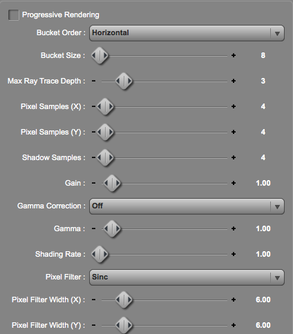

    Hi,
    I redid the test but using a simpler setup: 2 spot lights and camera close up on M5. I attached a screenshot of the render settings.
    In the surface tab, diffuse is at 0%, diffuse color at white, ambient SSS contribution at 100% pre-SSS - post SSS at 0, SSS material type at skin B and Subsurface Off-On is at 1.00.
    Subsurface Strenght.. oh.. crap.. it was at 0... that was my issue I guess...
    So, since I already wrote all this, can you explain to me the relationship between the diffuse and the subsurface strength, when I would have to play with these settings?
