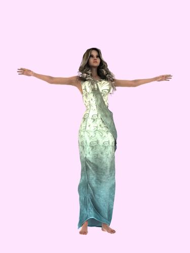

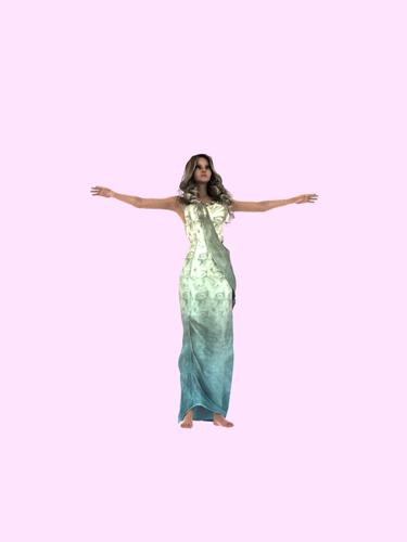

I have an issue with Lilith 6 that seems very weird to me. She gets stripes on her arms lika a zebra.
I haven't a clue what causes them or how to get rid of them. They only appear in the render, not in the viewport. What's even more strange is that the stripes appearence is dependent on both camera angle and distance.
As you can see in the pics there is only a hint of stripes on the close up and more apparent from some distance. I am very curious what causes this but most of all I want to get rid of the stripes.
Any ideas?

    glaseye2 said:
    Thx alot glaseye2!! That thread fixed it!
