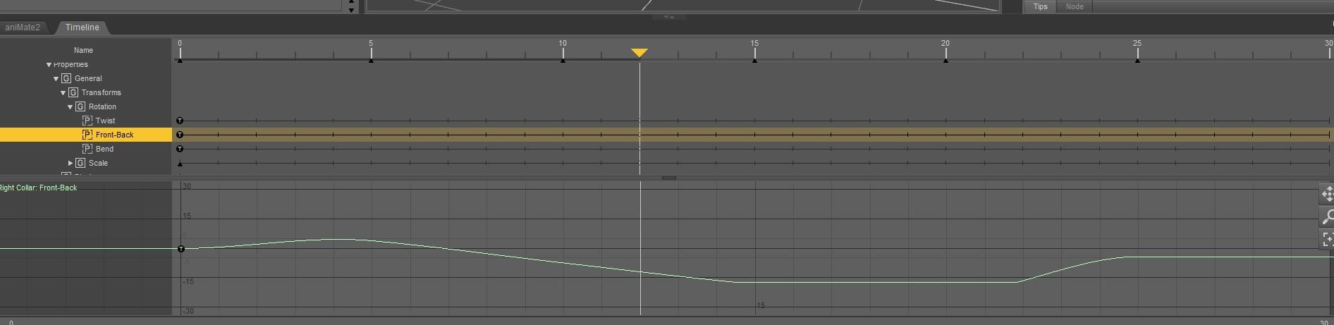

  • Looking at the animation graphs I've found a curve between 2 constant frames:
    Does that make any sense?

  • This is 100% a bug... the animation isn't solely driven by keyframes, it's partially driven by curves from "keyframes which previously existed", which is completely incorrect.
    There are people mentioning these issues in 2012. Does the Daz team simply not bother... or?
  • Look how random this curve is! laugh
    It's been completely mutated by something that has nothing to do with the keyframes?!
    Are you sure there are no pose controls, on the figure node usually, contributing?
    If I click through the frames, the pose control values change to reflect the random movement. But this is a result of the weird curve above which I can't flatten (there are no keyframes inbetween).
    Let me know if I can clarify.
  • Richard HaseltineRichard Haseltine Posts: 111,348
    edited November 2020
    The curve shows the movement of the joint, whether it's local keys or keys on other nodes driving the joint trasnforms through ERC. The first image shows the right-collar - no keys, bar the 0 time, but nevertheless it's curving all over ther place.
    The second graph shows the Pose Controls on the figure - lots of keys, and it's these thata re driving the curves on the right collar front-back (and each other, the Arms front back for example is driving the left and right front-backs to have kinks where they don't have keys).
    I'd think it might be a reasonable feature request to have some kind of ghost-key indicator for ERC links - but I'm not involved in deciding what gets implemented, so don't take that as an indication of whether or not Daz would agree.

  • The second graph shows the Pose Controls on the figure - lots of keys, and it's these thata re driving the curves on the right collar front-back (and each other, the Arms front back for example is driving the left and right front-backs to have kinks where they don't have keys).
    Thank you. Could you please show how you accessed the graphs for these Pose Controls?
    For example if I want to find the frames/graphs for the 'Left Hand Grasp' Pose Control, I can crawl through the timeline, but I only find rows for the bones and basic transformation nodes (bend/twist etc). Have you selected something special to view pose controls? (i.e. Arms-Up-Down)
  • So I just right clicked the timeline, selected Property Types, and realised there was a bunch of things hidden...
    Now the entire thing suddenly makes sense, well done Richard.
    I really don't think they should hide those other types by default. I get it's for simplification, but it just results in huge confusion.
    This is exactly what I talked about.
