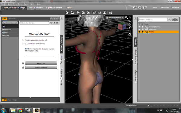

Is it possible to fit the V 4 clothes to Genesis 2 female?
Now it looks bad.

    You need V4 for Gen2F - it is a product you can find in the shop.
    edited August 2014
    there are some things (plug-ins) you may (possibly) need to purchase to do that. And in the end some things are hit or miss.
    There is a tutorial for doing that, and it has a list of requirements. That would be my first suggestion, and keep in mind, some things just don't "Auto-fit" like they should.

    And again, it is not a guarantee that it will work for all items, especially hair and footwear. Just look at the Skirt-joke in my gallery, it dose not auto-fit properly for many reasons.

    Does this help also adjust the hair? yes and no.
    That is the thing that is "supposed" to make V4 items (cloths, shews, hair) compatible with G2F via Auto-fit...
    there are pose controls, and they are very different from V4 to G2F.
    High-heal shews, often have poses to make the feet fit into them, the V4 poses do not always work on G2F.
    The same with hair and the shoulder pose controls for the same exact reason. Sometimes hair styles don't end up in the correct place on the head, and it can be a major headache to get them to sit on the scalp correctly. Sometimes you get lucky, and it just works.
    shirts, skirts, and pants almost always work.
