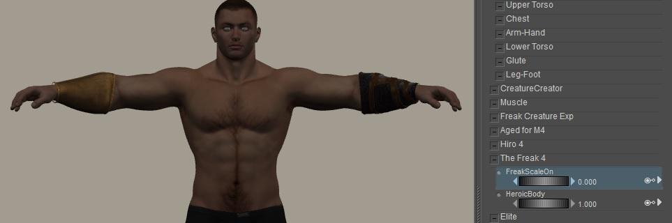

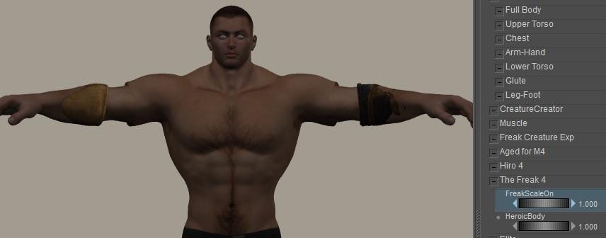

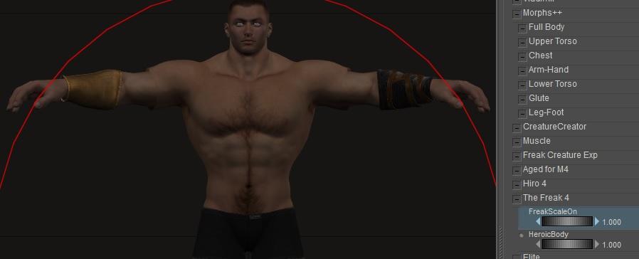

    That explains a problem I've noticed. I've been playing with the Barbarian King and Spartan Warrior, both from the DAZ store, and when I conform them to F4 the bracers were too small. It turns out that if I set F4s FreakScaleOn to 0.0 they conform correctly. If I dial up F4s FreakScaleOn his upper body expands and his arms stetch sideways, but the bracers don't. This gives the impression that they're riding up his arms and shrinking into them. Spartan bracer on his right arm, Barbarian King bracer on his left in the screenshots below with FreakScaleOn set to 0.0, 0.5 and 1.0 respectively. In fact I've just realized that the 'dent' in his upper arm is the result of his collar bodypart engulfing the unmoving shoulder bodypart as it expands.
    N.B. Lyrra Madrill's fix pose does not resolve this FreakScaleOn problem - I just tried it on the bracers from both outfits. Not surprised, as that pose was specifically a fix for the smoothing zone problem, not the scaling.

    Not on my render computer at the moment ... but what happens if you conform the bracers and then tick Copy morphs and Include scales in the Properties tab?
  • 3dcheapskate3dcheapskate Posts: 2,732
    edited August 2021
    That worked. yes
    (Just in case - the sequence I used: Load M4 (no morphs applied), Load bracers, tick Include Morphs and Include Scales for the bracers, Conform the bracers, set M4's F4Heroic morph = 1, set M4s FreakScaleOn morph = 1)
