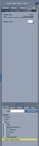

    At the top of the assembly room there is the row of icons for inserting different things into your scene. The one that looks like a target is the Target Help Object. Drag that into your scene. You can use its effects tab to change its color and size. You can rename it in the General tab.

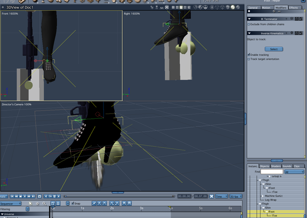

    Position it near the joint you want to pin in place. To lock a foot down on a V4 or V3, you would want to position the Target Helper around the ankle as that is where the foot joint's hot point is located.

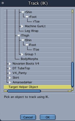

    Next, select the foot, and then the Modifier tab and under Inverse Kinematics there is an option to track an object. You can also track the object's orientation as well. When you click the button to track the object, a little window opens with the items in the scene. Choose the Target Helper and click Ok. You may see a bit of a shift in the foot and leg as the foot's hotpoint aligns with the target helper.

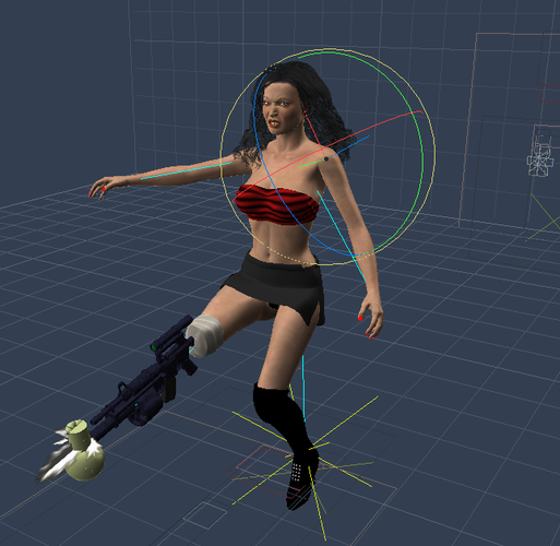

    I generally have good luck with it, but there are some things to consider. It will not pin something with no movement. If you move the Target helper out of range of the joints or figure, the figure will do its best to reach it, which can cause some unwanted effects. Joint constraints can also cause problems if you have the joint track the orientation of the target and you rotate or move the target in such a manner that you exceed the joint's constraints.
    To get around some of it, you can adjust the constraint. In my example, to keep the foot locked to the floor better, I changed the foot constraint to ball joint and changed the little constraint rings to Limited. You can see the difference in these two videos. The first one uses V4s standard foot constraint, and the second, I changed it to the ball joint constraint as described above.
