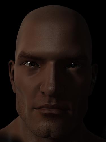

Just out of curiosity I made two pics to compare quality to see if there is any idea to make huge pics and then downsize them in Photoshop. I didn't expect any difference but as you can see, there is.
PIC 1. Just a straight render 450*600.
PIC 2. A render at twice the resolution 900*1200. Then downsized to the exact same size in Photoshop.
Since I am totally ignorant about the mechanics in Photoshop and Daz Studio I have two questions:
1. Why are the quality better in PIC 2?
2. Why is PIC 1 92,5 kB and PIC 2 123kB? (I expected them to be the same).
450 x 600 - 123K
450 x 600 - 93K

    The larger you render an image in DAZ Studio, the more details are in there. And Photoshop tries to keep these details when down-sizing an image.
    So it is kind of a "rule" to render large images in DAZ Studio (to make all the small details in textures and shadows visible), and then down-size in Photoshop.
    That is also why the second image has a bigger file size (because of more details in the image).

    In DAZ Studio, a larger render shows more details on surfaces and shadows. Like you are taking a photo with a real camera and you use a higher resolution (which means nothing more then a larger image size).
    In Photoshop, images with much details cannot be compressed like images with less details. That has something to do with the jpg compression algorythm. More details, less compression, larger file size.

    Reduction in recent versions of photoshop also includes a 'Bi-cubic sharpen'.
    I'd guess that's mostly what we're seeing.
    To get the same, direct from DS, you'd have to crank up the shading rate and probably turn down the anti-aliasing.
