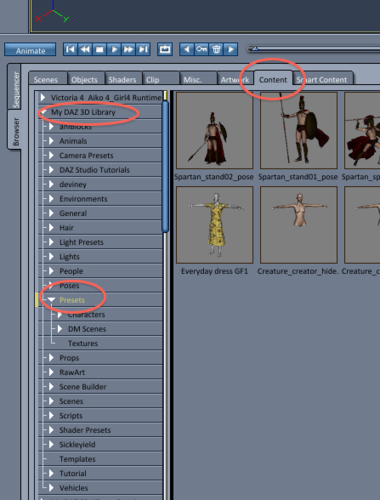

    OK, your Carrara 8.5 install should have created at least 3 folders in your content tab.
    "My Daz 3D Library Runtime"
    "My Library"
    "My Daz 3D Library"
    Content for Michael 4, Victoria 4, and earlier figures is generally in a format designed for the program Poser, which puts everything in a "runtime" file structure. Much of the Daz store content is also in this format so it can be sold to people who use Poser. This content should be installed to your "My Daz 3D Library Runtime" folder.
    Content for Daz's Genesis is in a .dsf or .duf format, and is not installed in the Poser runtime structure. This content should be found in your "My Daz 3D Library" folder. It includes Michael 5 and similar genesis based content.
    You can also use Daz Studio as a free plugin for Carrara. If you save a character or a scene from Studio, by default it will be saved to preset folders in the "My Library" folder.
    For your Michael 5 issue, some diagnostics to see if genesis is installed correctly.
    First, check to see if you have the "My Daz 3D Library" in your Browser "content" tab.
    Second, if you do, let us see if genesis is installed correctly. Navigate in the "My Daz 3D Library" folder to "People" / "Genesis".
    Third, if Genesis appears in your folder, click and drag it into your scene. It should load directly. If it doesn't, then you may need to install the genesis starter pack. If it does, then the problem is something else. There may be a subfolder under genesis for characters. See if Michael 5 is there. Try to load it directly.
    Another check, if you have Daz Studio, is to load Michael 5 in Daz Studio, save it as a scene in the preset folders in "My Library" and see if Michael 5 loads from there. Again, just doing diagnostics.
    Note - just to be annoying, the genesis based characters may appear in your "runtime" folder (Poser style files) but will not load correctly from there. Along the same lines, you will have a lot of folders in the non-runtime structure that appear empty because they contain Poser-style content which will not load from those folders. Annoying, but best just ignored.

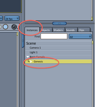

    Open a new scene and load a generic genesis. In the instances tray (bottom right), you should see a box with Scene, Camera 1, Light 1, and Genesis. Genesis has a little triangle next to it, which you can click to open the bone structure (body parts). Open it and you will probably see 2 genesis levels, "actor", and then hip/pelvis/...
    Highlight the actor level. In the box above it, called the properties tray, you will see tabs for "general", "motion",... Click on the tab for parameters. You should see some morphs listed. Either scroll through and look for Michael 5, or type Michael in the search box. Find the morph for Michael 5 (and confirm that it is there), and set it to 1. Did your character change?

    First of all, if you have the libraries installed to Carrara content, you should have two entries for My DAZ 3D Library.
    One of them is listed as 'My DAZ 3D Library Runtime' You do NOT want this library for loading Genesis content, it is ONLY for Poser Content (M5 is a morph of Genesis)
    The one you want is called 'My DAZ 3D Library' without the runtime folder on the end of the name.
    Selct My DAZ 3D Library, then go to People > Characters, and you should see several icons for loading characters (the display depends on how many you have bought) Among these, you should find 'Michael 5' You should also have 'Basic Male' and 'Basic Female' which come with the Genesis Starter Essentials.
    Double click on the 'Michael 5' icon, and it should begin to load, I just did this, and it takes about 30 seconds to load on my system.
    Just to be sure, you are using Carrara 8.5, and not an earlier version?

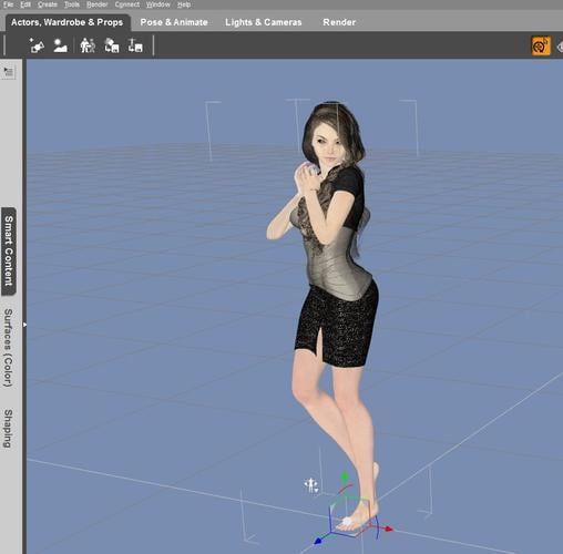

  • sukyLsukyL Posts: 251
    edited August 2014
    Hi Scott and everyone,
    I'm not sure if there are that many Mac users in the Carrara forum. I'm using OS X 10.6.8. with Carrara 8.5Pro. I pretty much load and manipulate most of my content Gen3 through Genesis 2 from within Carrara. I use DS for DUF conversions of older stuff and as a Gen 4 texture and clothing converter for Genesis 1 & 2.
    Here are some things that may or may not be Mac specific, but might help with the file situation.
    Do install Studio 4.6, Genesis and Genesis 2 starter essentials, but absolutely do not install the PostgreSQL CMS or the PostgreSqL CMS from Valentina CMS conversion on a Mac. I did, not knowing that it wasn't compatible for C8.5, and it completely hosed my Smart Content contents. I ended up uninstalling everything and starting over to fix it. Arg! Valentina CMS is the one to use for now.
    I load all my DAZ content through the DIM. I think these are the DIM defaults.
    Downloads go here: /Users/Shared/DAZ 3D/InstallManager/Downloads
    Installations are here: /Users/Shared/My DAZ 3D Library
    Applications here: /Applications/DAZ 3D/Carrara8.5 64-bit & /Applications/DAZ 3D/DAZStudio4 64-bit
    I’m not exactly sure which files are needed in Carrara, so I install both DS and PoserCF Mac versions when present. I keep manual installs and runtimes out of My DAZ 3D Library. I store other content in a separate location and manually add the folders to the Carrara Content tab. Since I find it easy to manage my content through DIM, the contents of My DAZ 3D Library is pretty fluid. I don’t install everything I own there, but add and uninstall as needed for projects.

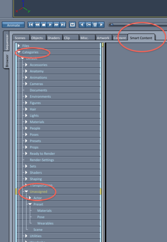

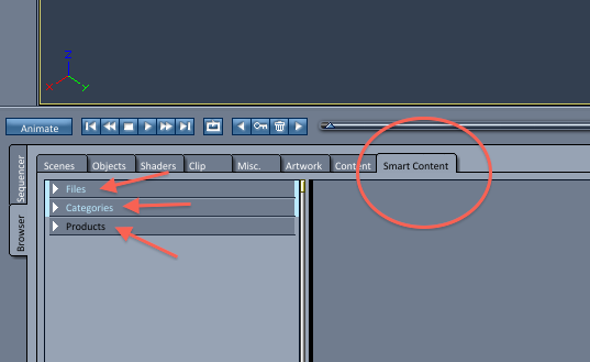

    I primarily use Carrara’s Smart Content tab to drag content to a scene. This is where the DIM installed items can be found (for the most part as some things inexplicably don’t show up). It seems like many people in the Carrara forum avoid this tab in favor of the Content tab because they prefer to set up their own file locations rather than use DIM, totally your choice. There are actually 3 parts to the Smart Content tab:
    1) Files – this is where actual smart content feature is. You need to select a content item, Genesis for example, in the Instances tab then click on either Files or one of the sub-directory categories within it (not to be confused with Categories below it) for it to search for related content. I usually don’t use the Files part because it can be pretty slow while it searches.
    2) Categories – This is the content arranged by categories like figures, poses, materials. This folder isn't smart/filtered by Metadata; everything installed by DIM will show up regardless of what you have selected in the Instances tab.
    3) Products - DIM installed content organized alphabetically (also not smart). I mostly use Categories and Products to add content to the scene. I also find myself using My Account>Product Library on the DAZ site as a catalog so I can remember exactly what the item is called to make searching the Smart Content tab easier. I really wish there were an actual search feature here like in DS.
    The Content tab is where you can also access your My DAZ 3d Libarary & My DAZ 3D Libarary Runtime, and folders that point to manually loaded content runtimes you set up yourself. Autodetect runtimes can make this pretty messy, but you can always delete the folders you don’t want from the tab. If I can’t find something in the Smart Content tab, I start clicking around in this one. You may find the names of a lot of content listed, but they don’t show when you click on them. Most likely it’s something not compatible in Carrara such as DS materials, plugins, lights, etc. I’m sure others have a much better understanding of this tab than I do.
    Finally, assets I’ve saved out from DS tend to show up either in Smart Content (tab)>Categories>Defaults>Unassigned or Content (tab)>My DAZ 3D Libaray>Presets.
    I hope there may be something useful here.
    Good luck. It may take a while to get used to the way Carrara works if you are used to another application (I can't really wrap my head around DS), but it starts to make sense and can be a great tool in your collection. There is a lot of useful information on this forum and YouTube videos.
    Here are examples of what I'm talking about with the Smart Content and Contents Tabs. I was hoping I could place them within the text to make more sense. I hope they load.
