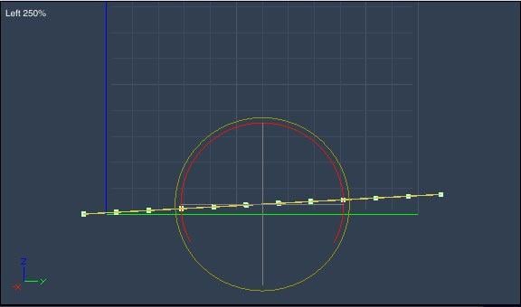

    DUDU_00001, I have attached some pictures, hope it helps. Just create a box with segments. Create a simple morph for it (see it rotated at a slight angle?). When you apply the Bend Modifier, the paper will roll into itself as Design Acrobat said, but applying the morph will prevent this.

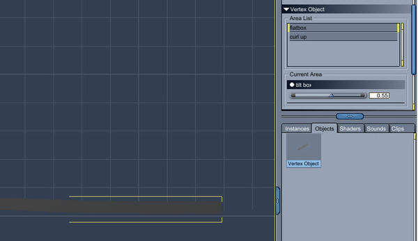

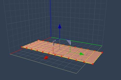

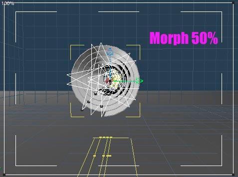

    Morphing is just the moving or rotating of vertices. You might here additional terminology used with DAZ or Poser models, but that's basically all it does - moves - rotates vertices
    Be in the Model room and in our case, have the flat box ready to go and ALL the vertices highlight - because we are going to be moving the entire box with by rotating it slightly (tilt) to get the effect of an offset 'rollup' like a carpet or paper roll.
    1, Create Morph Area - Give it a name always :)
    2. Create Morph target and Edit it
    3. Move the vertices . - In our case we move all of the object on a rotation or tilt.
    4. Click validate
    You're done
    I made another morph target that curls up the end just to show one can have one or many morph targets per object
    One can also save morph targets for the same model, so you don' t have to keep re-inventing the wheel (but must be identical model)
    You are probably thinking one could use morphs to open and close doors/windows or move lids etc and you would be right. Morphing is more than just making lips pucker and eyes blink on DAZ and Poser dolls.
    Note: the pics are out of order, but they are there matching the description in the instructions.

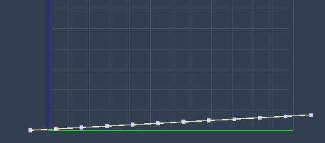

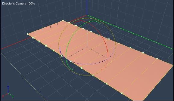

  • DesertDudeDesertDude Posts: 1,239
    Hi DUDU_00001,
    I have attached a few more pictures. In my example I was unrolling the object down the Y axis. The "tilt" morph needs to run in the same direction. Then, in the Bend and Twist controls set the Axis to Y. Hope that helps and sorry for any confusion.
