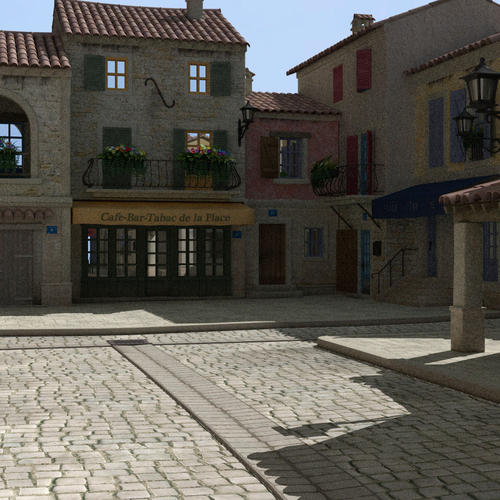

    It's not a terribly good example, but this is Provence with a single distant light for the sun and uberEnvironment 2 set to Bounce mode (it's the Bounce light from the light itself, with no settings changed).
    1000 x 1000 - 217K

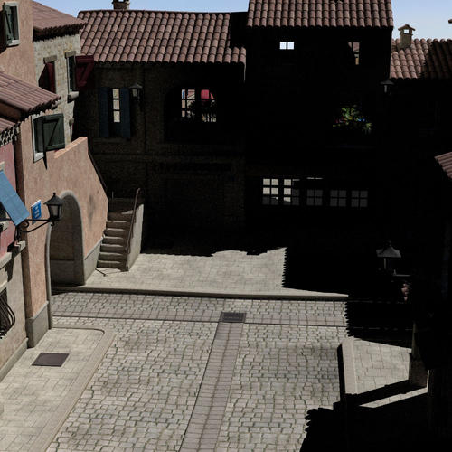

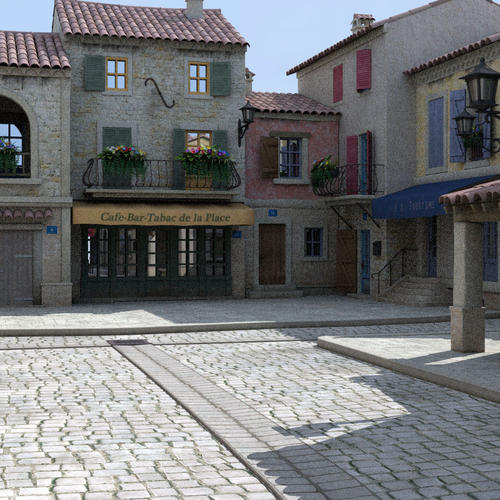

    In most of its modes uberEnvironment is using an HDRI map as a light source -the sphere is there solely as a visual guide, it isn't a functional part of the light. There is a setting Maximum Trace Distance that controls how far it looks when determining occlusion (if you have selected one of the occlusion options) and bounce - if your enclosed space was coming out dark that probably means it was smaller than the trace distance and so was completely occluded (while my render above was prrly lit because the trace distance was too low to reach the sky dome). I made two more renders, from a different viewpoint as I lost the original; one has the trace distance turned up far enough to reach a (shrunken) Provence skydome, the other uses a second UberEnvironment 2 with the trace distance deliberately turned way up so that the buildings were occluding and preventing light from coming in from the light at angles the sky wouldn't have reached - the original render took about fifteen minutes, the increased trace render took about eighteen, and the double UE2 took about twenty-five (but I had turned the occlusion samples up to try to reduce the increased graininess from the two lights - though none of the renders would be acceptable as a final image); all renders were done using the progressive render option, which can be faster for intense calculations but does seem to make noise more noticeable.
    1000 x 1000 - 278K
    1000 x 1000 - 333K
