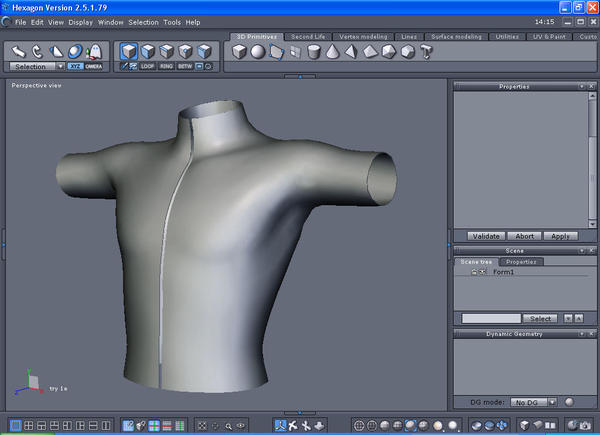

Hi there,
I have today for the 1st time completed a short-sleeved vest in Hexagon. This was done from Ghastly's resource kit for Genesis. I have exported it from Hexagon as .obj (wavefront) to My Documents. I have 2 files now: ghastly vest try 1e.mtl and ghastly vest try1e.obj
I have copied it to My Libraries but can't find it. To which folder can I copy these 2 files for DS to show it correctly under Content Library? Since this was a resource kit for Genesis I want to try and see if it will fit Genesis 1 properly. This is only an .obj without any textures, just plain and simple vest. Any help is appreciated! :-)

    To be honest, I have NEVER done any clothing modeling ever before, this is my very first try. The conversion you mention, what do one needs for that? I have no clue. Is it covered in the forum you mention? Up to now I have only used ready made models to use in my personal renders, but that is it! But I really wanted to try my own things and the resource/starter kit is very helpful. In fact, this was also my 1st ever modeling in Hexagon too and with the great help of Patience55 I got this far ... at last! ;-) But I have many learning still ahead to create my own stuff! LOL
    EDIT: I got it!! Just remembered now I saw yesterday a "send to DS" option in Hexagon - and there it's appearing automatically - indeed under "Other Import formats". Now just have to go and try fitting it on Genesis, whether it will conform since it's still only an .obj! :-)
    EDIT AGAIN: Definitely needs to be in Daz related format! :smirk:

    Still trying with the same .obj format file. The only thing about this is unfortunately it can't be used this way with Genesis (fitted onto) and thus when one pose Genesis the vest stays behind (can't be posed). I kind of get it to fit manually onto Genesis as you will see in the attached images but this is it! :blank: The vest front opening line looks also strange!! :smirk: Is it because of the .obj format? The original Hexagon file have a more straight opening line (see my 1st comment above for image). But remember, this is my first ever clothing model!! I have to learn a lot and really needs advice.
