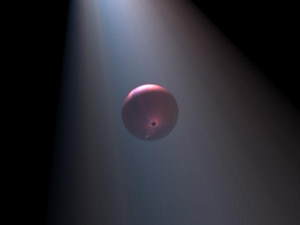

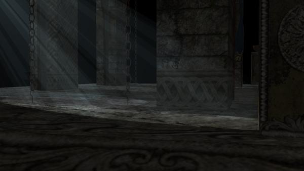

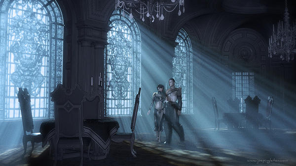

I have been trying to figure out how to recreate the fog effects from Reality 2 for DAZ Studio in Carrara with LUXUS for Carrara.
I have been trying the shaders from LUXUS for Carrara Resource. But I can't seem to get them to work right.
Attached is the kind of effect I get from REALITY2. Is there a way to create this effect with LUXUS for Carrara?

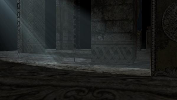

    I had been trying the dust shaders in PhilW’s Luxus for Carrara pack. I don't think I am using them right. I was able to combine the LUX render with a Carrara default render using the light cone feature. This is the result. Its better but not as pronounced as the Reality 2 experiment. More experiments are needed.

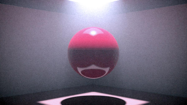

    Attached is a simple test using PhilW’s Luxus for Carrara pack Dusty Interior material. More experiments are needed.

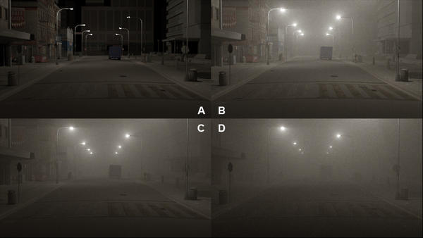

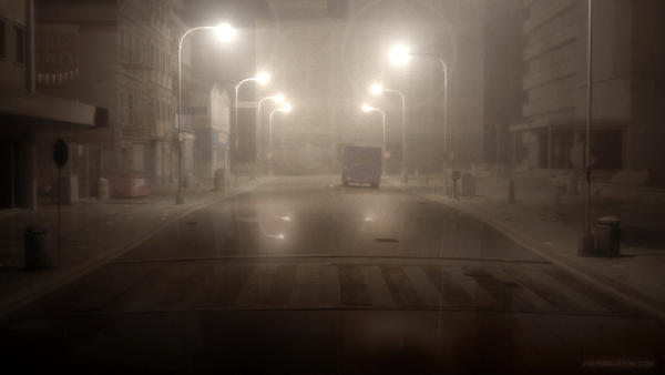

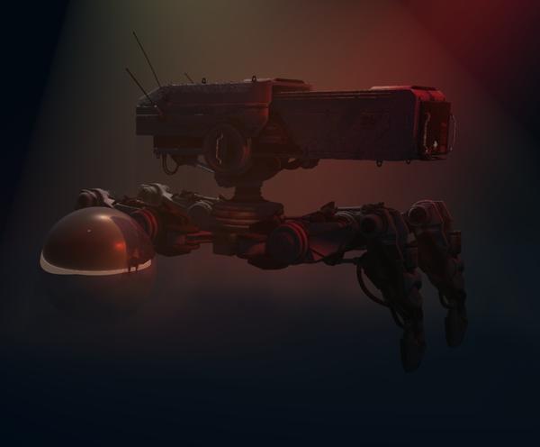

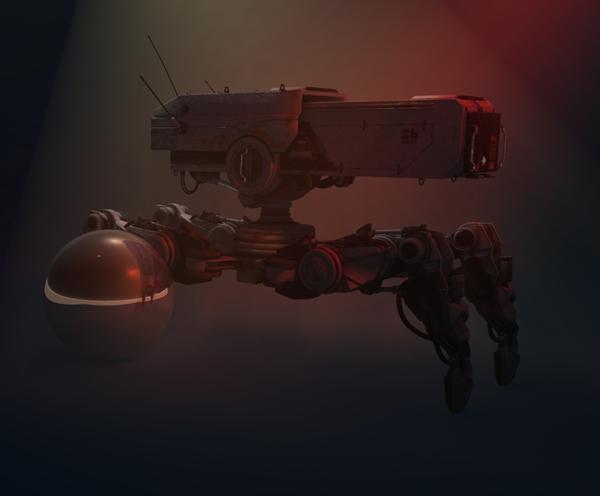

    I decided to do some more experiments with fog in LUXUS and thought someone may benefit from my findings. This time with Urban Sprawl 2 The Big City from Stonemason.
    Attached is a demo of a scene with different settings based on these shader base settings
    Top Shader: Lux Surface;
    Material: Lux Glass 2;
    Interior: Lux Lux homogenous;
    Fresnel: Other value of 1;
    Absorption: Lux constant color: color:50% grey, value: 0.00;
    Scatter Coefficient: Lux constant color: 50% grey, value: 0.05;
    Scatter Asymmetry: Lux constant color: 50% grey, value: 0.05;
    Exterior: NONE;
    Area Light: NONE;
    A: No fog settings
    B: Base Fog Settings
    C: Scatter Coefficient: Lux constant color: 50% grey, value: 0.10; Scatter Asymmetry: Lux constant color: 50% grey, value: 0.10;
    D: Scatter Coefficient: Lux constant color: 50% grey, value: 0.25; Scatter Asymmetry: Lux constant color: 50% grey, value: 0.25;
    So it appears that Absorption determines how deep the light appears. Scatter Coefficient and Scatter Asymmetry effect the blurriness.
    Also attached is a image with all the effects combined in Photoshop.
    Thanks for looking.

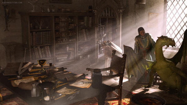

    More experimenting with the LUX volumetric shaders settings above and Opus Magnum from Faveral.

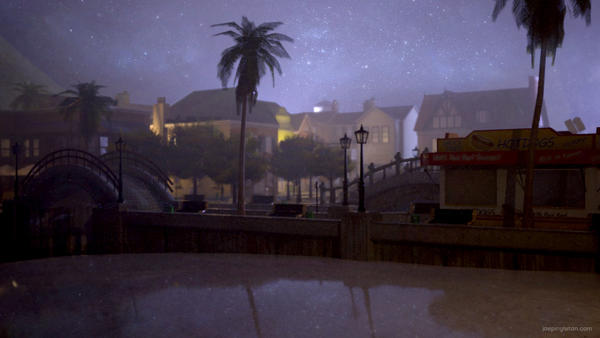

    More experiments with Carrara 8.5 Pro and LUXUS for Carrara. This time I was experimenting with the LUX volumetric shaders settings above and bulb lights with Sandy Bay Seaside Village from 3d universe.
    View the stereoscopic 3D version at 3dLive
    960 x 540 - 140K
