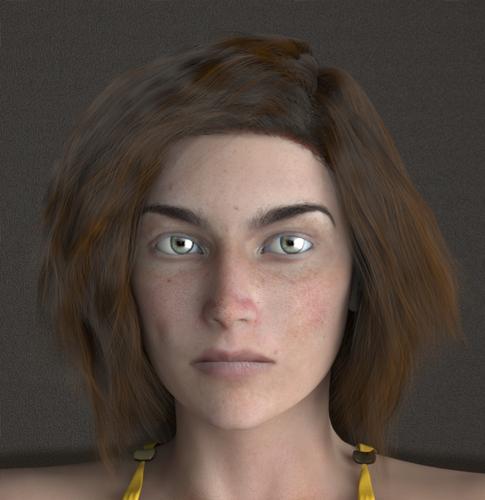

Yeah, it's unintuitive and frustrating, but if you stick at it, you can get far better (i.e. more realistic/believable) results than with transmapped hair.
This is part of a hair set I'm working on. Still have a bit to fix here—as you can see, there's a bit of unwanted hair intersection going on toward the back by the part—but I think we're getting there.
If you'd had success in the hair room, feel free to post your renders!
583 x 601 - 207K

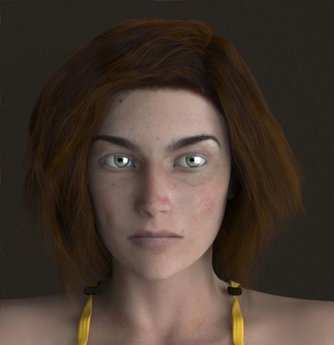

  • believable3Dbelievable3D Posts: 0
    A bit more work on fixing the style as well as curing the artifacts.
    583 x 601 - 147K
  • edited December 1969
    Looks good, so far.

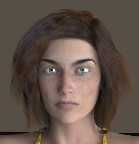

    Slightly more dramatic lighting, with a wall behind her.
    583 x 601 - 186K
  • Hermit CrabHermit Crab Posts: 884
    I agree, this is looking very good.

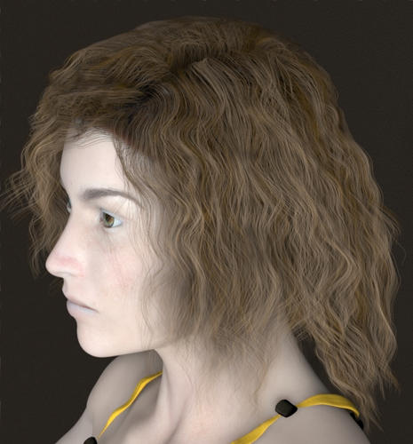

    Due to some early grouping issues, I ended up having to redo the right side. But that's okay. I'm pretty happy with how things are progressing. The style will have a straight but slightly messy base version and a wavy version, as well as possibly a curly version. Here's the wavy version with my light brown materials. This is one of my fave hair shaders so far.
    579 x 623 - 216K

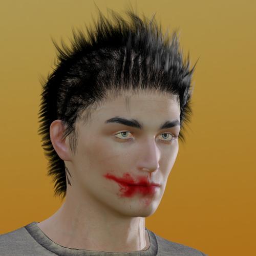

  • DarwinsMishapDarwinsMishap Posts: 4,087
    I, too, have been playing with the Hair room- yesterday took up most of my time in there.
    I'll have to thank you for the clumping and density tips- I was trying to figure out why the hairs were not getting out of that neat grid on the guy's skull for an hour...lol
    I have a zone for the bangs, a zone for the top, a zone for the back, one each on the sides, and a final zone at the edge of the skull cap for fine hairs- I'm actually going to break it up more. I'm thinking ten zones total to help keep the math of the hair count in check. Right now, there are about 150,000 hairs on there. So not finished, but it's progress.
    800 x 800 - 236K
