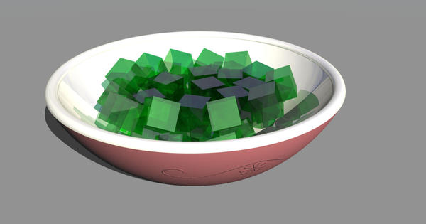

Okay, so I was hungry, and had a craving for a bowl of gelatin. I decided to have the kind cut into cubes. I'm having a bit of trouble getting the cubes in the bowl properly.
The problem is arranging the cubes chaotically without having them fall inside each other, or sticking through the inside of the bowl, or "hovering" away from the bowl inside. The default wireframe edit mode just does not cut it for this. Switching to top and side views is not only cumbersome, it still doesn't get them touching, but not overlapping.
I also realize I should leave it all in the basic Bryce grey texture until I've got it done, then add the proper textures before rendering, but I put the textures back in for the sake of the render and screen shots. In the finished work I think I'll have Orange gelatin instead. I'm also going to add a procedural to make sure the sides of the cubes look ridgey like when you really cut gelatin ... only the top is still perfectly smooth. May even add some bubbles.
In the render here you see 40 cubes. In the end there will be more like 100 piled up well over the top of the bowl, (I'm really hungry), but it makes no sense to go on if the beginning isn't right. As it is, what you see here isn't really chaotic enough. There are not many places where the cubes overlap slightly into each other, but too many are laying simply flat with not enough of them rotated on the X and Z axises.
I was going to lay down the first layer, then duplicate that a few times with rotates, stacking higher and higher, then remove some on the outsides of the top layers to make a pile shape. I did not want to lay down each cube separately, but even that is extremely difficult in the wireframe mode.
I tried doing some multi-replicates with different recipes, then "dropping" them into the bowl, but they misbehave ... some falling right through the bowl for some odd reason. Most want to fall through the other cubes, but stay in the bowl. Real gelatin would have simply bounced out of the bowl, of course.

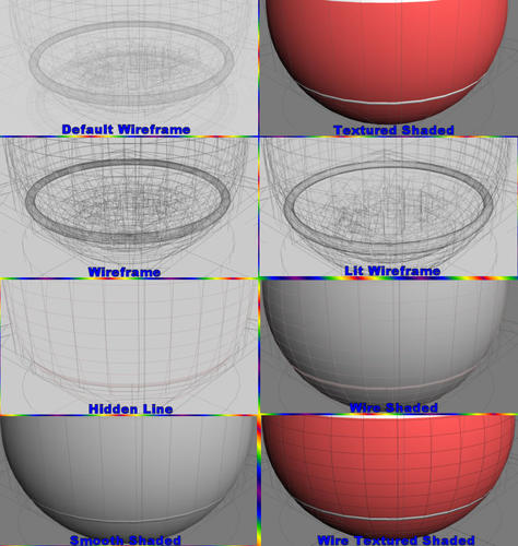

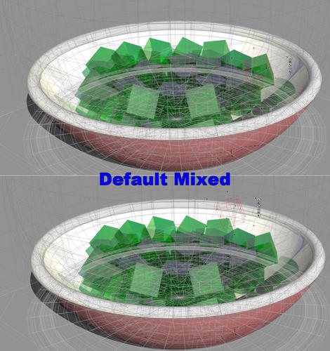

The only way I can really see where the sides of the other cubes and the bowl are is to use one of the "shaded" edit modes. The problem with that is; the shaded modes shade everything, including negatives. So I can't even see the inside of the bowl. In those modes.
There's also the Default Mixed mode, but all that does is overlay the basic wireframe over the last render. If you move something, the wireframe moves, but the solid object remains in the scene where it was.
So I decided to think outside the bowl. That's how I got the configuration you see now. I built these first two layers outside the bowl in Textured Shaded mode, then moved them back into the bowl. Working in that mode is very slow. I had to guess where the side of the bowl would be, and got it WAY wrong. Now that they are inside the bowl again, very few touch the sides of the bowl, and some are sticking into the side of the bowl. Some seem to hover.

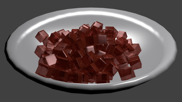

    The point is: you make a stack of blocks in Blender, in mid-air, over a bowl. You animate the blocks pouring into the bowl, using Blender's rigid physics engine to arrange them automaticaly and chaotically, without overlaps. (You can even create soft blocks that bend under gravity, like jelly.)
    You export the scene as an OBJ file, bring it into Bryce and have at it for lighting and materials.

    Well, believe i or not Guss, I donate :) I firmly believe in encouraging the development of good software.
    Here you go, CT: https://dl.dropboxusercontent.com/u/13900881/tuckIn.obj.zip Just delete my low-res bowl, plonk the cubes in yours and delete the ones that look dodgy. No cube overlaps/intersects any other cube.
    30 mins of setting up, 30 mins of p*ssing around. Excuse the crap material and lighting, but this is 126 blocks of processed-animal-hoof-flavoured-by-product. Colour/flavour to your taste.
    Enjoy!
    960 x 540 - 365K

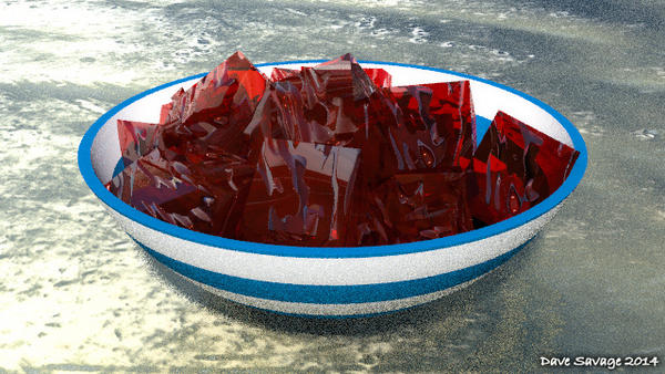

  • Dave SavageDave Savage Posts: 2,433
    I'm working over at the office today, but I did leave a jelly render cooking when I left home this morning.
    I used a combination of random replicate, drop to floor, manual placing and boolean modelling.
    It took 10 minutes to set up... I'll post the result when I get back home tonight :)
    My quick go at Jelly...
    640 x 360 - 222K
    edited August 2014
    Oroboros said:
    Savage: Nice material and lighting :) Mine was a rush job done entirely in Blender - it took 2 minutes, and kinda looks it :D
    Thanks Oroboros. Mine took about 10 minutes in Bryce (and then quite a long render for what it is).
    I used a material I made last year (originally, it was made as blood), edited slightly reducing refraction and adding a wavy bump channel.
    The main secret in mine though is to make a solid block of cubes and then do an intersect boolean with the jelly cubes and a duplicate of the inside geometry of the bowl (which in this case I made quickly from a positive and negative sphere and a negative cube.
    That way you don't have to worry about placing the cubes into the bowl and as you can't really see below the surface, it works fine.
    I suppose I could have used Rashad's extra primitives to create slightly round edged jelly cubes, but I don't think CTippetts has those. I'm not sure now when they were included with Bryce.
    edited August 2014
    I did start a thread a few years ago called "Show Us Your Bryce Animations" but I think I was the only person who posted in it and it quickly got lost through lack of use. :D
    I have no specific questions. I'm quite used to Bryce animation... Though I see a trip into the Motion Lab may be needed and that place is an almost total mystery to me.
    I did try a Beta version of Blender for a short while a few years back (I also tried Carrara and Vue) and some people get such excellent results from Blender but it was clunky on my Mac and crashed worse than Bryce does. :D
