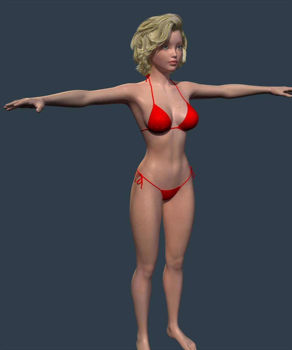

  • DiomedeDiomede Posts: 15,464
    edited January 2021
    Test 1
    I noticed that many of my purchased G2F character skin maps lack skin variation (I think).  To try to get more variation, I tried using mixers for Thorne's Ysabeau maps and Forbidden Whisper's merchant resource maps.  To blend them, I used a mixer of (a) fractal noise and (b) spots - at 50% mix.  I applied the mixer to every skin channel that get maps, such as limbs, torso, ears, etc., but not stuff like teeth.  The maps are color, highlight, and bump.
    Other than that, the settings are pretty close to a standard Ringo skin setting, including subsurface scattering.  Here is a test render with indirect light enabled.
    EDIT:  The figure morphs are a mixture of mostly Ysabeau 6 and Callie 6, with a little Victoria 6 and Lotus 6.
    1000 x 1200 - 44K
    710 x 845 - 117K
    910 x 902 - 141K
    818 x 837 - 119K
    816 x 840 - 115K
    763 x 859 - 117K

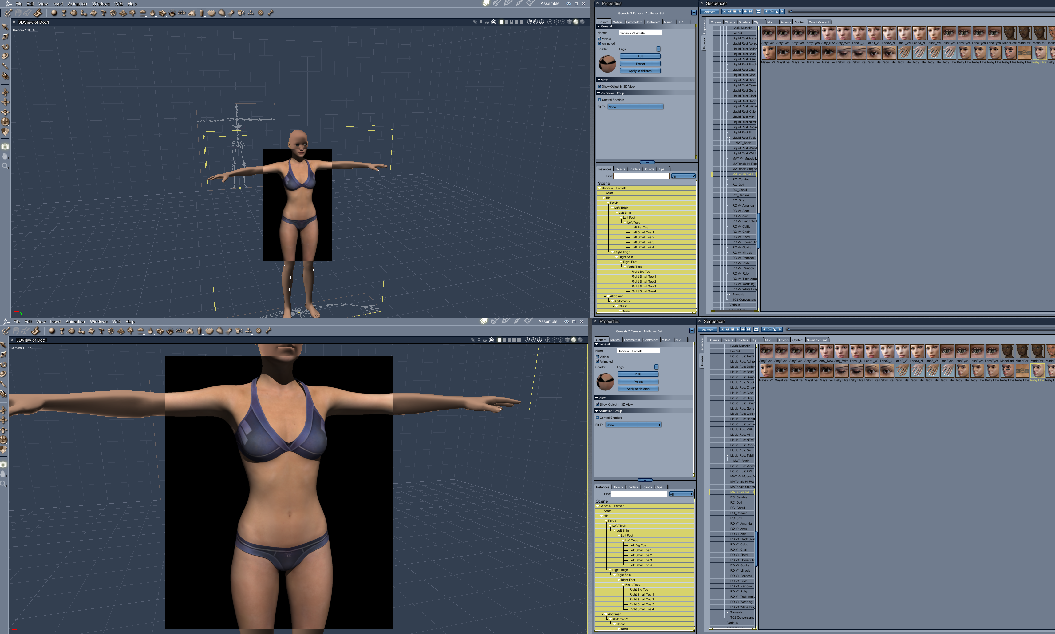

  • Bunyip02Bunyip02 Posts: 9,345
    edited January 2021
    Eeeek on the V4 Elite with the Carrara shaders, will try converting with the Batch convert tool and see what happens....
    2617 x 1046 - 534K
    Post edited by Bunyip02 on
    edited January 2021
    Looking good.
    Test results from Batch conversion, UV better but some slight gaps.
    2769 x 1037 - 544K
    edited January 2021
    Found slight gaps in the seams for Elite Amy, Maya, & Reby Elite. However when I zoomed in on Reby Elite the gap vanished. Elite Lana & Marie both looked okay.
    3432 x 2062 - 1M
