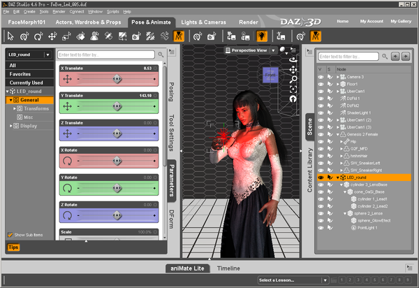

    I use this method in the attached pic. The lights are uberlightbars with linear point lights on top of them.

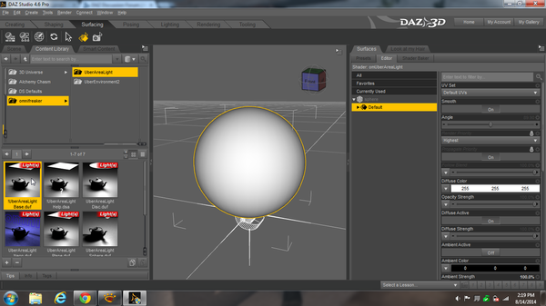

    Sorry, can you explain what you mean? I assumed you meant apply the UberArea base to my lightbulb. Is that not what you meant?
  • kaotkblisskaotkbliss Posts: 2,918
    That may be what it's called. I can't remember off-hand and I can't check since daz is still in the process of a lengthy render :( But I hope you see what I mean from the pics. (I thought I had the name of the objects correct)

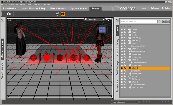

    oo! the making of real light fixtures. This I like already.
    In the past, I played with putting a simple uber panel into a fixture made from prerogatives. kind of a pour-mans florescent fixture of sorts. It worked well as it was a regular uber-light with a box around it. Then later on, I put a "Dz Light" in a square can of sorts for a shadow-in-shadow test. Again, I did nothing to the DzLight other then place it in a primitive made fixture.
    I have had some difficulty with the applying that uber-surface thing to other objects. lack of a clue, or just bad luck I guess. Let me get some coffee, and read the rest of this. (yep I need coffee, lol. morning)

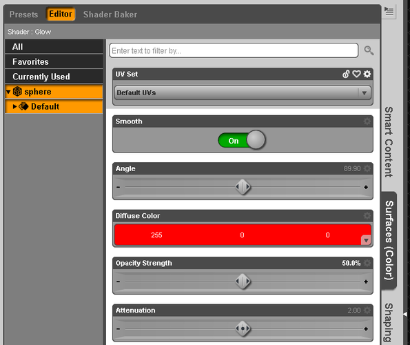

    There is the "Ambient" it controls how bright the surface is in direct view of the camera angle. The Intensity controls the light emitted from the surface (per say). I modded the settings a tad, to get them into one screen-cap under "Currently Used". Ironically, in a digital realm, 255 255 255 is as bright as you can get, lol.
    Now, If the light is in that 'Glow effect' of another object, it will be dimmed considerably, unless the Glow surface settings are reduced in 'Opacity' considerable. And as 'jestmart' has so accurately pointed out, to much 'Glow Effect' is not realistic at all for most real world conditions. Lick Echo in a song, it must be used sparingly to add to the scene, rather then muddying it out completely.
    1479 x 813 - 142K

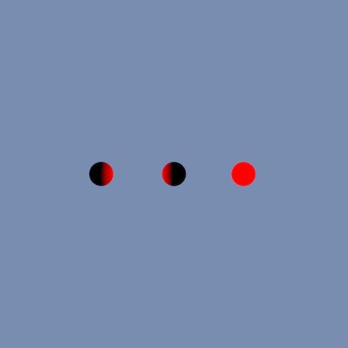

    When you have reached pure white on the light surface, the light it's self can not get any brighter, that is where dimming the rest of the scene, to bring out the contrast becomes an art form. Perhaps even using the Gama in the render tab somehow to make the uber surface brighter if it is not pure white. It's an option.
    100 x 100 - 238B

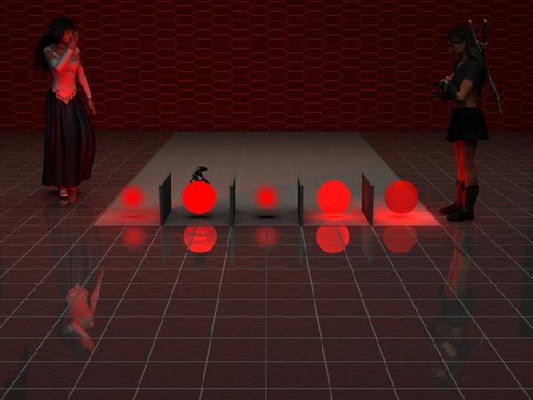

    I duplicated the thing, so I could get a few more angles, now it is time to kill the ZDG-Box lights, and try some random things.
    I am open to ideas as well, them Uber Spheres are as white as white can get.

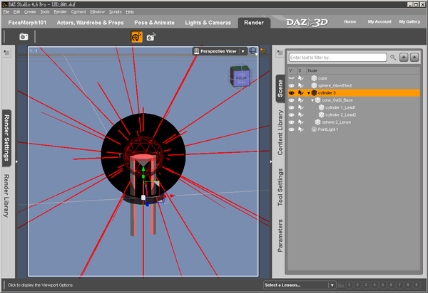

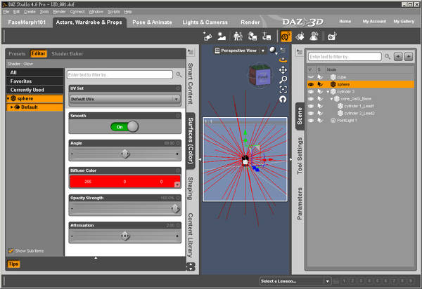

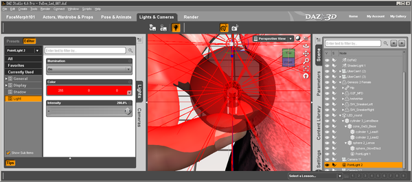

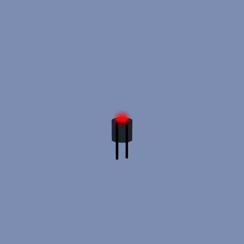

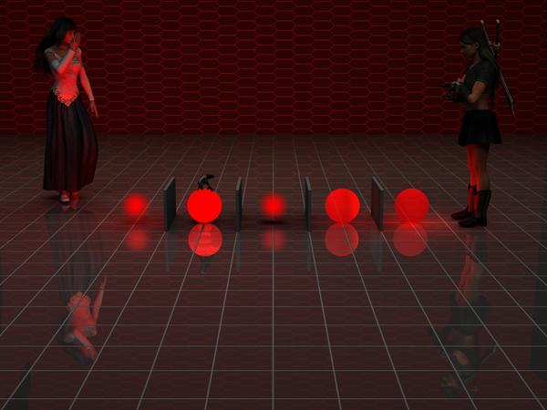

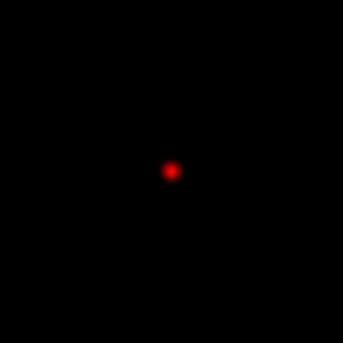

    Interesting side effect with that "Glow", or the "Duplicate" feature. If the sphere is not completely in view, the fuzzy edges are not so fuzzy.
    This is the invisible Uber light spheres outside the "Glow" effect spheres test.
    900 x 900 - 476K

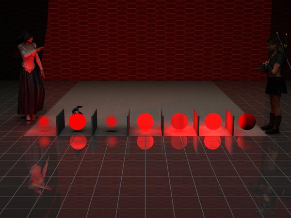

    I decided to try something a little different, like an old incandescent bulb.
    The Uber Sphere; Opacity 25%, Phantom Off.
    The "Glow" effect sphere, a tad larger this time.
    900 x 900 - 476K
    818 x 713 - 327K

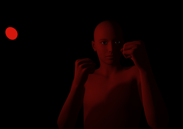

    here's mine
    I used a spotlight (left settings at default)
    primitive cone with the UberVolume Dust shader applied
    and an Area light sphere with opacity at 15%, intensity at 1000% and ambient at 200% and the color at white
    500 x 500 - 274K
    500 x 500 - 65K
