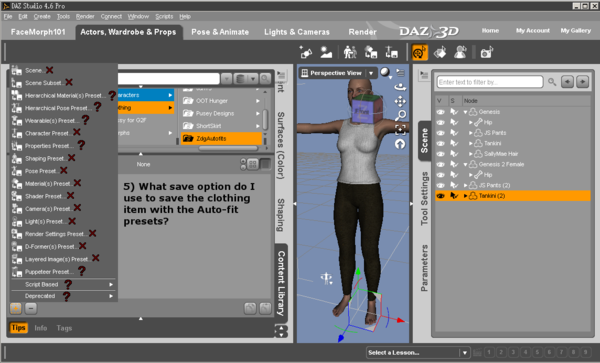

It has been described many times, for example A4 to G2F. That the item needs to be fitted to V4 first, then saved. Then the item fitted to Genesis 1, then saved. Then fitted to G2F, then Saved...
Every step requires the Item to be saved after it was fitted to the next figure in line, How? I'm kind of stumped at step 5.

    If I was saving an A4 piece of clothing for G2F, there would be no need to apply it to V4 first, and then save it. I would simply use Autofit to fit it to Genesis, then save it using Save As > Support Asset > Figure/Prop Asset.
    Once I have the Genesis version, I can then use Autofit to fit the new item to G2f, and save that the same way.
    The save as option, saves a DUF format file, and you can put it where you want in your content library (My DAZ 3D Library), you can create a new folder for Autofit conversions or place them wherever you like as long as they are inside a DAZ Studio Formats library.
    Is that what you mean?

    So I use the "Figure/Prop Asset." to save something after it was auto-fitted?
    So none of the items in that "+" menu are what I'm looking for?
    I've just auto-fitted that shirt to G2F , I want to save it so I don't need to mess with Auto-fit again, for this example. None of the tutorial enplane that one step, how to save it, lol.
    I have questions with just about Every-single thing in this save options window.

    Lets back up a tad. Hypothetically speaking, I just converted a shirt from V4 to Genesis 1. How do I save it, so I can auto-fit it to G2F?

    Save it the way I described earlier.
    Make sure you have the now converted item selected in the scene pane, go to Save As > Support Asset > Figure/Prop Asset. Save it to somewhere inside you DS library folder, even create a new folder for it inside My DAZ 3D Library if you like.
    Once you have that .DUF files saved (it will save with an icon), you can then load it onto G2F, and now select Genesis as the supported figure. Same thing again once you have it fitted, save it to your library. Obviously you woukld want to name it G2FFit or something, or simply save it into the G2F clothing folder in a new folder called Converted or some such name.
    Does that help any?

    But isn´t the option >Save As - Wearable Preset< what you are initially being looking for?
    Please take a look at this : http://sickleyield.deviantart.com/journal/Tutorial-Clarification-Wearables-Presets-417253297

    I have never used >Figure/Prop Assets< and I don´t see any advantages of it. I think this is the way to do it if you have modeled a prop or clothing item on your own. But if I have understood your initial post correctly, you have the outfits already available in your DAZ Library.
    If you choose >Wearable preset< a dialouge pops up, and you can select which parts of the outfit to include. You can check everything or only one.

    Now it is the V4 Lirio Dress. There is a checkbox to include the pose. But if you reload the Wearable preset it will fit to any Genesis shape in every pose via Auto Follow. And DAZ Studio will not pop up the AutoFit Dialogue again.

    Loaded the Wearable to Genesis2 and each item was Autofitted again, this time from Genesis to Genesis2.
    Now I can save the second Wearable Preset ... and thats how I had interpreted your initial post.

    If you have selected V4 in the scene tab, you will save this as wearable preset for V4. Cancel this dialogue if you want to save a G2F Wearable preset.
    Just click on the Genesis2 figure in your scene and go to File->Save as->Wearable preset.
    In the dialogue make sure the autofitted components and necessary props are checked and uncheck everything else.
