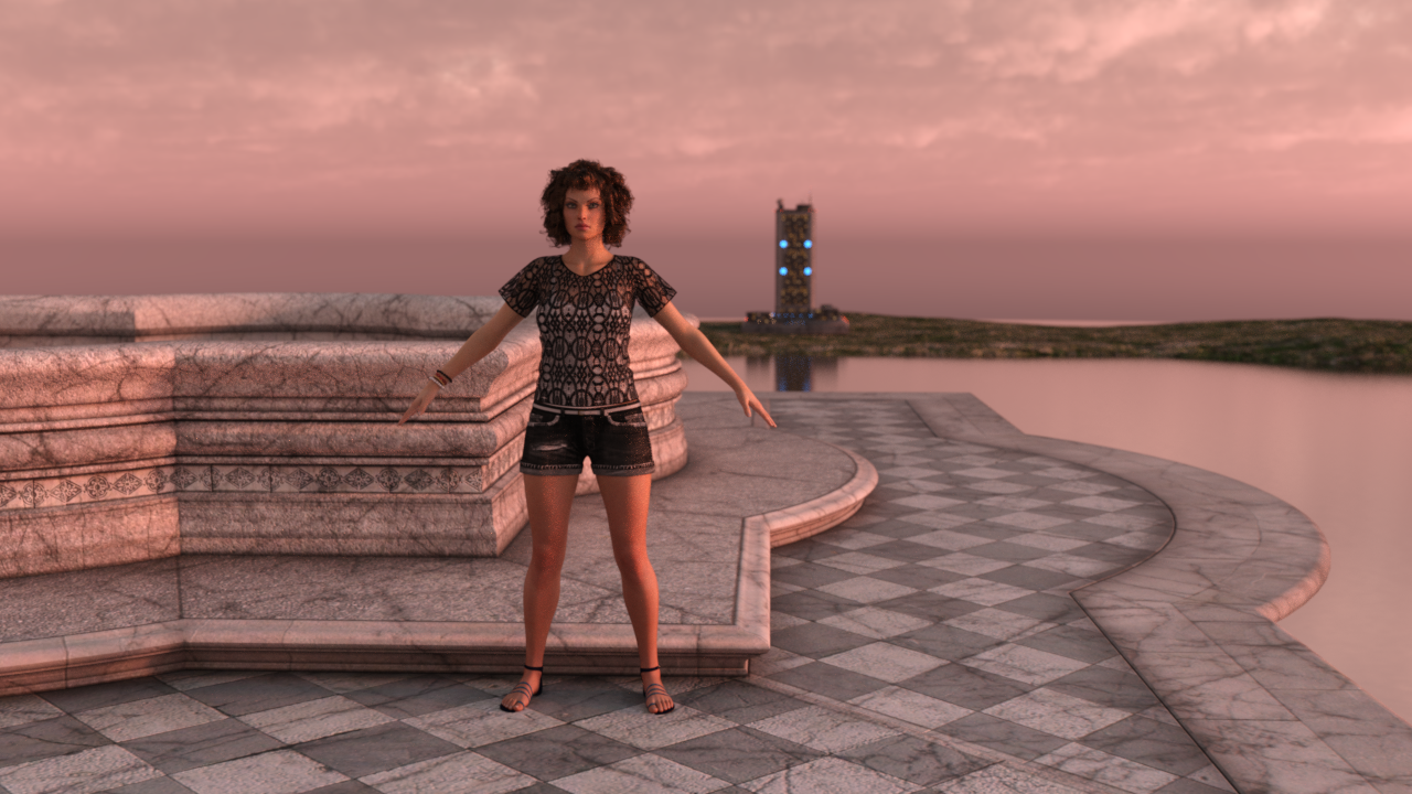

So I am in the process of setting up a backdrop for a scene, and I'm trying to determine what works better when working with distant objects. Should I scale everything 'correctly' and move objects to their real-world location, or should I scale distant object down and keep them closer to the camera? Part of this is triggered by working with the one set I plan to use as a backdrop as it is scaled approximately 1:20 (https://www.daz3d.com/future-cityscape-density-blocks). Rescaling it up is no issue, and manually moving them into the distance is also not terribly difficult. The question is: should I? Working with large scale scenes in Daz has been a frustrating learning curve. The lack of scalable scrolling or movement that I know of (like say, Blender's) makes navigating a large scene irritating, if not downright impossible, especially when the focus tool stubbornly refuses to focus on the actual selected object (and instead scales way out).
This isn't a gripe, but rather a question of best practices. Does the camera and scene work better with properly scaled items (as in, less fiddling)? Or is there a relatively good way to manage smaller scale models in a middling distance?
I set up two shots, first scaling the building 'correctly', then moving it to a reasonable distance away (180,000 units, or around 1.8 km, unless I really misunderstand units in Daz). I did not use matte fog as at that distance even the 10,000 m setting almost completely obscures it. I then brought the original building in and moved it until its size was approximately the same as the distant building, then duplicated the scene parts (Terradom BZone and Water and the building) and scaled/moved them to match the distant building. Outside of horizon placement (which could be corrected or obscured with more distant terrain), they more or less render the same. But which is better, especially working with a larger backdrop scene?
Camera setting are the same in both scenes, Depth of Field is on, and centered around the figure in the foreground, with F/Stop not too tightly on her).
I suspect there is no 'right' answer, but I am interested in any thoughts on the matter.
1280 x 720 - 1M
1280 x 720 - 1M

    This one looks better, even thought the horizon is still a little too high.  However at this time of day a photograph including a person would have a much larger aperture and much less DOF.  The scale of the tower looks fine to my eyes in both.
    This one is the "correct" scale one. laugh
    I personally prefer this one. The last 3 months I've learned more about camera work than in the last 40+ years... More advice is welcome!

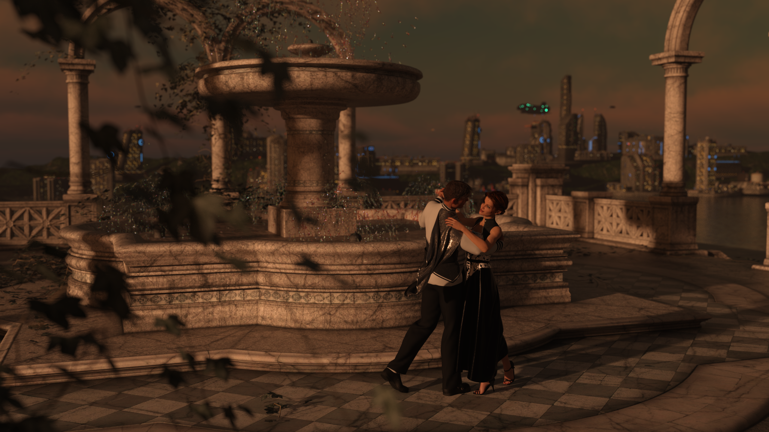

    So I've played about a bit and finished (mostly) a full scale test. I experimented with some of the fog settings and have found, effectively, something that works, at least for me. Without too much preamble, this is meant to replace the background in another render, so I've included it here for comparison. My initial render always felt, to me, like the buildings were almost toy-sized in the distance. This new one feels much more realistic. It has the advantage of properly showing distant object parallax (I think that is the right word for it) when the camera is shifted.
    Buildings are almost 400000 units away (4km), so nearing the edges of the practical visible flat-plane horizon. With building objects and instances, there are about 60 buildings in the shot (several layered), and are arrayed in an approximate 'realistic' city grid (minus roadways). Textures are mostly stock, save for converstion to Iray and an added emissive map to properly emit the window lights.
