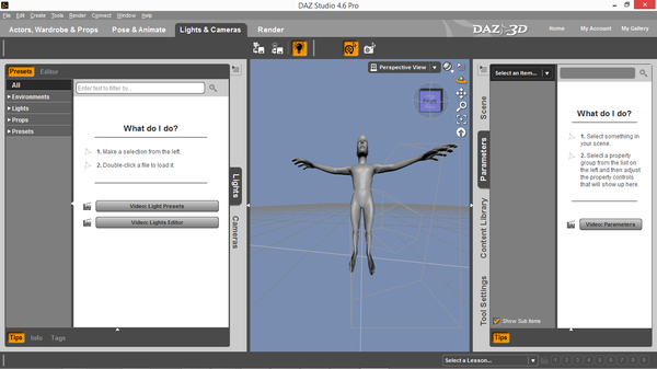

I have terrible problems with distortion today as portrayed in the attached screenshot. If not using perspective view, which distorts the figures, I can't use the globe tool to spin my view and so on. It's basically frozen in place. I simply loaded DS a minute ago and got this weird result straightaway. What can I do? Reloading the camera and the whole scene did not help...

    Click on the white disc with a cut-out arrow, bottom of the column of icons at top-right of the viewport, to reset the camera. The focal length has somehow ended up set very low. The perspective View is not saved in scenes or camera presets, nor are changes to it tracked for undoing.

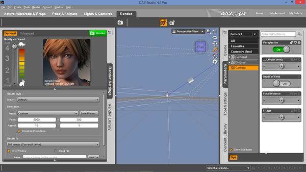

    I did what you advised me to, Richard, thanks. However, it did not fix anything. I fiddled with the camera parameters, but to no avail (I tried setting focal length to 100 and more). I'm posting a screenshot of the parameters I get with the default camera (and each new one I create). Any ideas? I really need to move on with a project. If it won't clarify soon, I will have to reinstall DS.

    You are viewing the scene through the Perspective view, not the camera you are adjusting. Click where it says perspective View at top-right of the viewport and select your camera from the list.

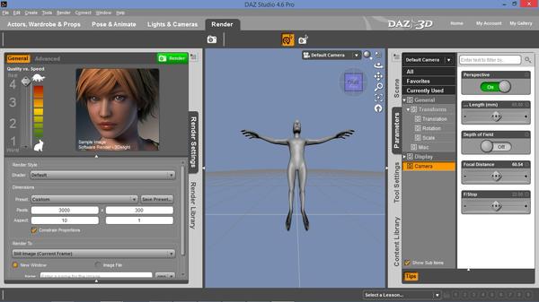

    The screenshot was made using perspective view, you're right, but using the camera view gives the same results.

    Ah, I think it's at least in part the extreme aspect ratio you have - 10 to 1, so the actual render is going to be just a narrow strip across the middle which won't be distorted.

    The reason you have a 10:1 ratio is because you are missing a "0".
    Your frame is set to 3 thousand (3000) x 3 hundred (300).
