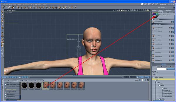

    Here is how to apply the shaders.
    1) From the Instances Tab select "Actor".
    2) Applying the shaders drag and drop the selected shader on to the multi-color "Multiple Shading Domains" sphere.
    3) This should apply the shader properly to Victoria 6.
    See the attached image file.
    1773 x 1029 - 882K

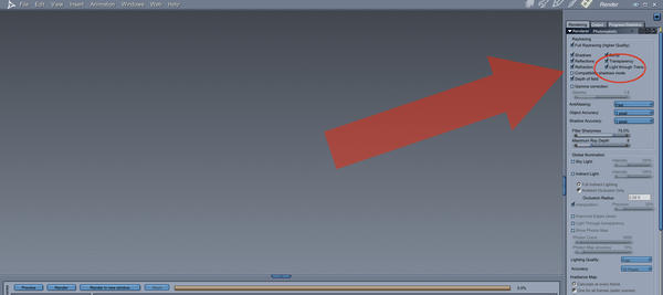

    As Wendy was saying, if you have light through transparency deselected, the light will not pass through the transparencies (alpha maps) in the eyes and lashes, turning them black.
    Go to the render room and make sure that "Transparency" and "Light through Trans." is checked! ;)
    EDIT: Click the image to enlarge

    Thank you all for your replies, but especially Dartanbeck. I think I've got it resolved now. Dartanbeck's picture up above showed me what was wrong. I had understood I needed BOTH Light through Transparency checked. I did not realize I needed Transparency checked instead of the second Light through Transparency. I did try eliminating the fake GI which didn't make any difference. I'm re-rendering now and it looks much more promising
