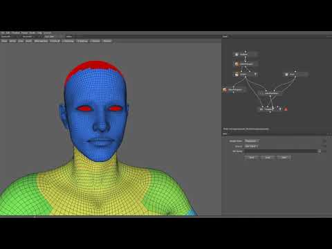

3- In Wrap (2020 in my case) I'm following this tutorial
at 0.25 speed 'cause whoaw! I create a LoadGeom node for each, then off the G3M node, I create a SelectPolygons node, double click G3M and from the " - Polygroup " tab I select UpperJaw, LowerJaw & Tongue. I do not load in a .txt file (possible suspect right there!)
4 - I create a subset linking G3M and the SelectPolygons node, and then a SelectPointPairs node between the subset and the scan node.
5 - Before wrapping I create another SelectPolygons node from the subset and hide everything behind the eyelids, everything up the nostrils, everything inside the eard drums and everything behind the lips; then Invert, Unhide All, Invert to have what was hidden selected in red. What isn't red should now be computed to wrap.
6 - I then wrap with these settings (subdivisions 3, another suspect right there!)
