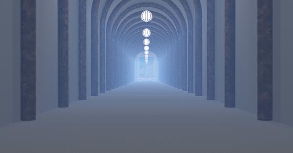

    Last night I decided to try to render this thing as it was at the failure point. I never got to putting the marble all over the walls, pillars, and floor. That's a fast rendering wood texture on the pillars I only put in to distinguish them from the Bryce grey walls. Since I was going to let it render overnight, I decided to turn on AAA superfine with soft shadows. At 2 PM this afternoon it still had hours to go, so I stopped it here.
    You can at least see what a 3450 Bryce Unit hallway would look like. That's Victoria about halfway down on the right. The picture on the end wall is of the Petrified Tree at Yellowstone, but you can't tell from this far away with all the haze.
    Rendering this also revealed I didn't have my pillars all the way on the ground ... did not realize that until this render. I had only viewed it from the center of the hallway near Victoria. Or, it could be that all of the pillars are the same "Y" up, but, due to how long this is, only the ones closer to X=0, Z=0 are touching the ground, while these at the end of the hall are off the ground due to the curvature of the earth. [insert goofy grin here]
    That's 12 radials bouncing light all over the massive amounts of polygons involved. Don't try this at home, kids.
    Oh, hey! Since that's a petrified tree image at the end, could this qualify for the Tree Challenge? [insert insane grin here]
    Anyway, now it's time to scale it down to a reasonable size ... later. Thanks again, Horo!

    @CTippetts - impressive hall. TheSavage64 gave you excellent advice. With soft shadows, do go premium. Plop render a part of the shadow transition with a low rpp setting, start at 9 or 16 and look at the noise you get. Then increase rpp by a step if not satisfied until you're happy. Usually, 36 or 64 rpp is enough. Each higher step doubles the render time.
    You can render soft shadows in regular but it usually takes longer than going premium and set the rpp. Superfine is really only for those that want punish themselves. If you go animation and have the camera moving, you can get away with a lower rpp setting.
    Again, don't waste time by rendering out a scene before you think you've got everything right. Use Plop render and just render the critical parts. For an overall impression, switch off all premium effects like soft shadows or set rpp to 4 or 9. You'll detect flaws like hoovering columns also in low quality.
    I know I shouldn't pick on typos, given my record for making them, but I have to admit I would mind some of these
    You’ll detect flaws like hoovering columns also in low quality.
    I would like some of them columns to give a hand with the housework. :coolsmile:

    Hehe, ok then, columns that do not touch the ground firmly.

    @TheSavage64 - Yes ... I think that's the point of all of this, including the reason to send my render here. I went WAY too big. It's one thing to go big for a static image, but, what a mistake for doing a video.
    I knew about the haze and such. I think I even mentioned it. I kept it there for this particular render, because it does help show the scale of this, when you consider these are all Bryce default settings.
    When I look at my folder with my Bryce models and such, I don't just peruse the file names, because, over time, even if I was quite descriptive in my file names, I forget what the heck the thing was about. So instead I look over the thumbnails for the the rendered images, (for which I keep the same names as the BR5 file). I wanted to make sure, days down the road, I recognized this one as a failure. I only went for the Premium because I knew I was going to let it go overnight.
    Yes, I had already edited my radials for soft shadows. The first time I rendered this, (in regular render mode), those ribs I wrapped around the spheres that surround each radial light, (with no soft shadows), were casting a very distracting criss-cross pattern all over the walls and floor. (I think the spheres were about 80% transparent, with100% specularity, ambiance of about 45, and refraction about 160, to make sure most of the light got out of the sphere, yet the sphere would glow.) Then in a subsequent render, but before this one, I forgot that I turned off "cast shadows" completely. So, the only shadows the AAA had available to soften in this render, were from ambient reflected light. Just plain stupidity, I guess. Real waste of time and processing. [insert image of head hanging in shame here] At least I have my failure reminder.
