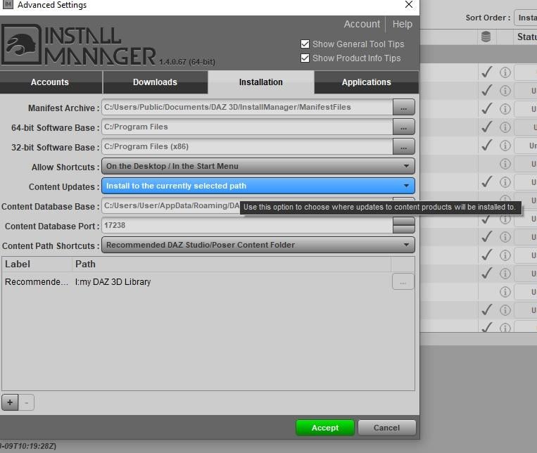

    Yes, I know it's the Beta thread. As I'm on 4.14.0.10, I'm looking to download the latest 4.14.1.22, to see if it will cure my current crashing issue. If I launch IM, it doesn't list an update avaialble for DAZ Studio, though I'm on 4.14.0.10.
  • solarview said:
    WendyLuvsCatz said:
    this is the Beta thread, do you mean your release build is 4.12?
    The Beta you need to use install manager AFAIK
    Check the Download filters (Advanced Settings) in DIM, is the Public Build checked?
  • DoctorJellybean said:
    solarview said:
    That did it. Thanks, Wendy!

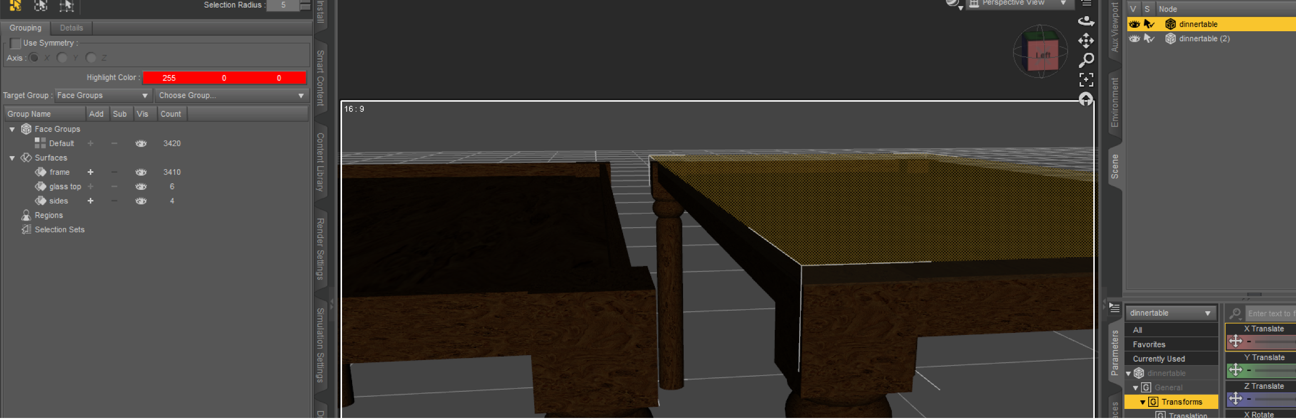

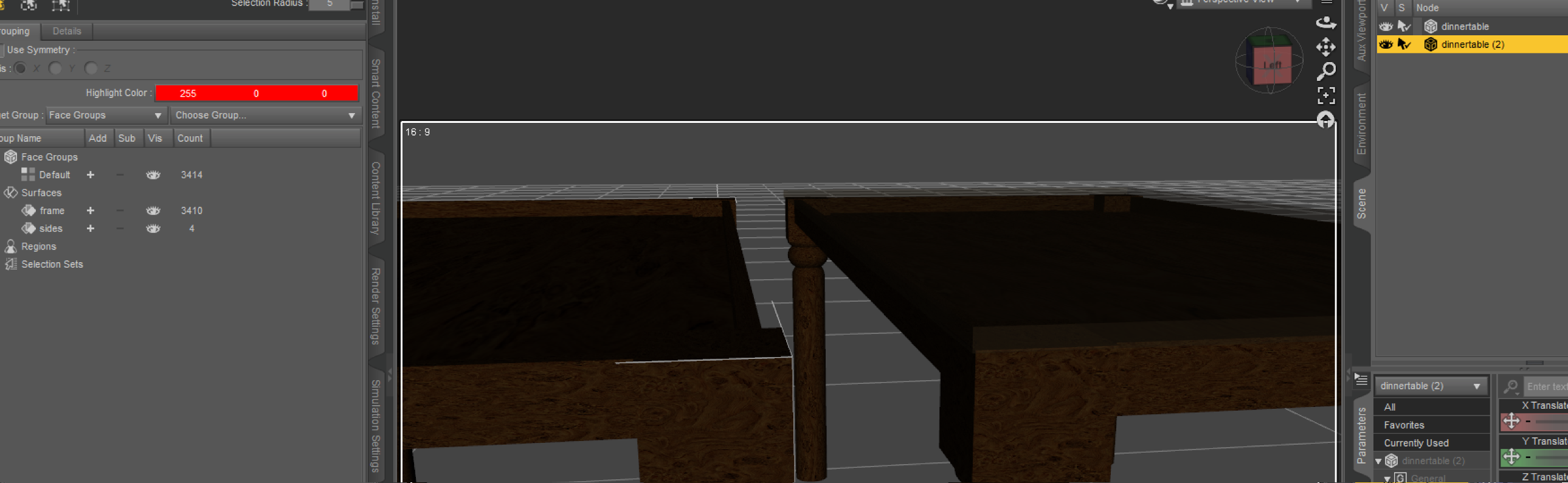

    After I perform an Iray render of a High Resolution object, the Daz Studio 4.14.1.22 Public Beta viewport reverts displaying the object at Base Resolution. This bug seems to affect only the viewport. A subsequent Iray render still renders at High Resolution, even though the viewport is displayed incorrectly. This bug occurs when I have BOTH subD and smoothing applied the the object in the viewport.
    I submitted help request #360403 and attached a video demonstrating the problem.
  • Saxa -- SDSaxa -- SD Posts: 882
    edited December 2020
    Got the same as you.  The subD gets lost after the render.  Not included in the redraw.  Do any transforms (no matter how miniscule naturally) and it redraws to proper look in viewport (iray previw or variant of texture shaded).  So appears to be a redraw issue occuring after render.  Changed one of the draw setttings to continuous - didn't help.

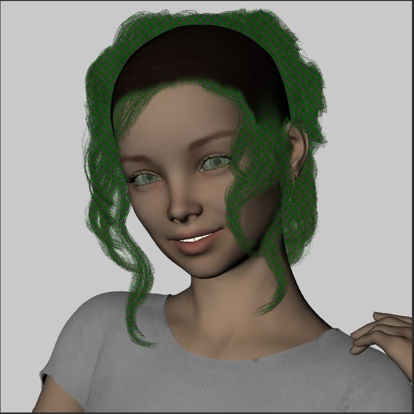

  • I don't know if it's the new version of the beta but my fur stopped rendering in a Filament animation

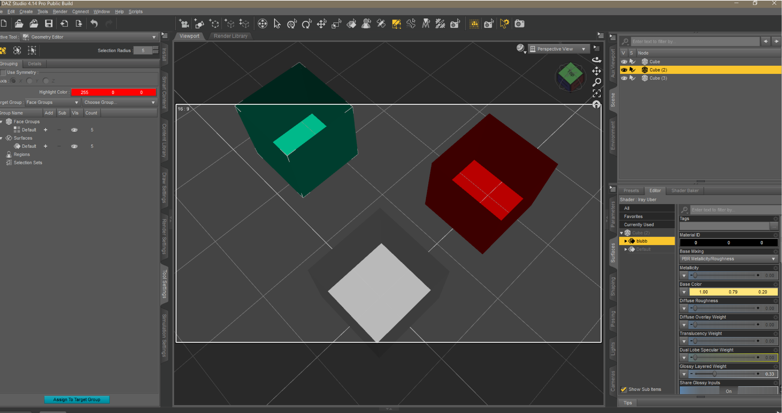

  • It also seems that geoshells are not rendering correctly in this version.
    Part of the character geometry overlaid with geoshell becomes transparent (i.e. missing triangles) in Iray when the character is moved far from the center of the scene (say -6000 on X axis). The geoshells I tested are using mesh offset of 0.010-0.020, scene lighting doesn't matter (default dome and scene or sun and sky both exhibit the same issue). Adjusting the mesh offset to larger values seems to work around the problem.
