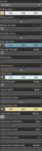

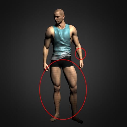

Hi Guys... well i'm having some problems, i made M5 With Surface Active (No Subsurface Base Shader) and is showing black lines in legs and arms , I think something have to deal with Group ID or Shading Rate? How can fix this?
These are the settings

    Try adjusting the Sub Surface scale, or try lowering the Sub Surface Shading rate. Are your lights using Raytraced shadows, or do you have lights with Deep Shadow maps (or no shadows)?

    I am with Richard, SSS Shading rate is far too high, 2 - 4 will do fine. Scale could be lower about 1.00 should do.

    That actually looks like something that would look good in a scene with window blinders. :)

    Thank you Richard Haseltine I fix it! the Subsurface Shading Rate was very high, I put in 0.0.... Thanks guys for helping me :cheese::cheese::cheese:
