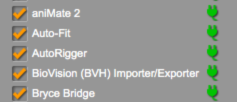

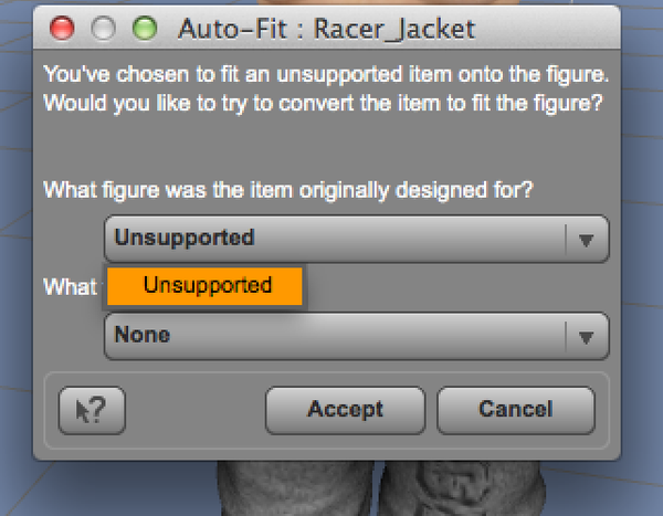

Hello,
I've just noticed a little problem with auto-fit: there is nothing in the first drop menu...."what figure....", while the second menu is fine....
I was trying to fit a Genesis clothing on Genesis 2 Female....the weird thing is that it's happening only on my mac while it works perfectly on windows....I still can use it choosing that only option "unsupported" but it doesn't work perfectly.... anyway it seems to be installed, as you can see....what's happening?

  • BellaBella Posts: 458
    Hi Totte,
    there should have been everything, everything I have is on win and on mac....
    Reading what you said I tried to load this lesson http://www.daz3d.com/using-auto-fit-genesis-to-genesis-2-female
    and then I've got the error I attach ...
    The funny thing is that I had those files installed.....I tried to uninstall & reinstall but the error is still there....I'm confused!
    848 x 340 - 45K
  • TotteTotte Posts: 15,304
    Are they really installed to a directory that DAZ Studio has mapped to it?
    Sounds like you have not mapped the directory that things are installed in correctly.
    You got it but I swear I had done it!!....then it had somehow come back to the previous folder that is now empty....
    So....problem solved, now it works!
