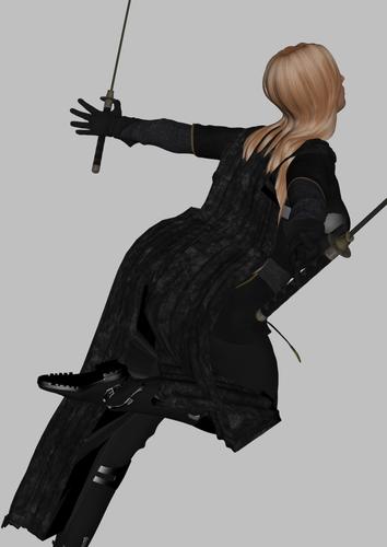

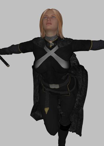

Now, I've finally created my protagonist in G2F, full six and a half feet tall. For those wondering how I solved the problem that was spoke of in my previous thread, I actually just transfered the AMR morph with transfer utility and then used ERC freeze and such to get the scaling to work. Now here is my new problem, her cape. Autumn's outfit is essentially the Night Guard gear with a few tweaks. Now, I knew this was always going to be a problem when working with clothing from a previous generation, so my first thought was 'Hey, I'll just the Genesis 2 version.' I then realized I would have the SAME problem with the Genesis 2 Male verison, because it would be put on through Autofit. If this was any other cape, I could just parent it and not fit it, but that doesn't work with this one because of it's straps (You can see them on the second render). So, the question is, is there any way to 'un-pose' the cape but leave the rest fitted?
So, the question is, is there any way to ‘un-pose’ the cape but leave the rest fitted?
No there isnt.
But, heres what I would do, take the fitted one and make the cape invisable in the surface tab leaving the straps.
Then load another cape but, dont auto fit it. Parent it in place and make the straps on this one invisable.
