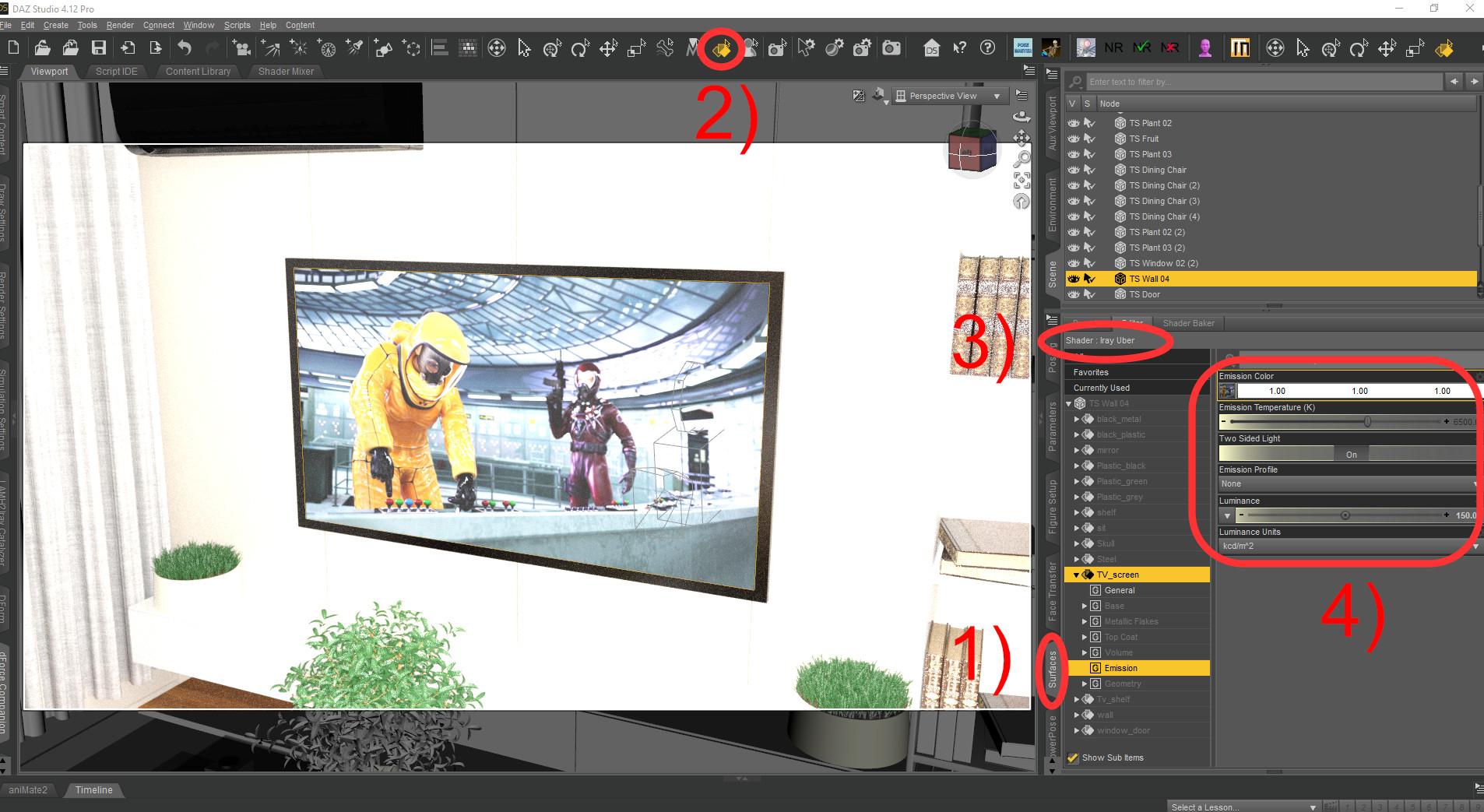

    Actually it is quite easy in this case:
    1) Make sure you have the surfaces pane visible
    2) Select the surface tool and click the inner black part of the television
    3) The television has an architectural shader, switch it to IRAY
    4) Select a 16:9 bitmap and put it in the Emission Color property. Also put it into the Base Color property of the TV_screen surface
    1906 x 1043 - 458K
