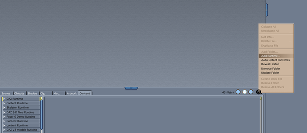

    You may have to point Carrara to the runtimes on the external drives the first time. Then it should remember the locations provided the drives are mounted.
    To point Carrara to a runtime, select the Content Browser tab, and on the top right side of the browser window there is a little, black icon. Click it, and it will give you the option to add a runtime. I don't know if the Auto Detect Runtime scans external drives or not. BTW, the icon is contextual, so if you're in the Objects Browser, or Shader Browser, it will give you the option to add folders of those items.
    A note about my screen shots: I don't have C8.5, so I don't have the Smart Content tab, just the plain Jane Content tab, so my screen shot will look slightly different than your version, but from what I've seen the icon is in the same spot.
    1174 x 508 - 91K

  • KharmaKharma Posts: 3,214
    thank you evilproducer, that helps :) For some reason I always find installing Carrara and its addons difficult as files don't seem to end up where I want them or I can't find them from inside carrara...why I do not know.
