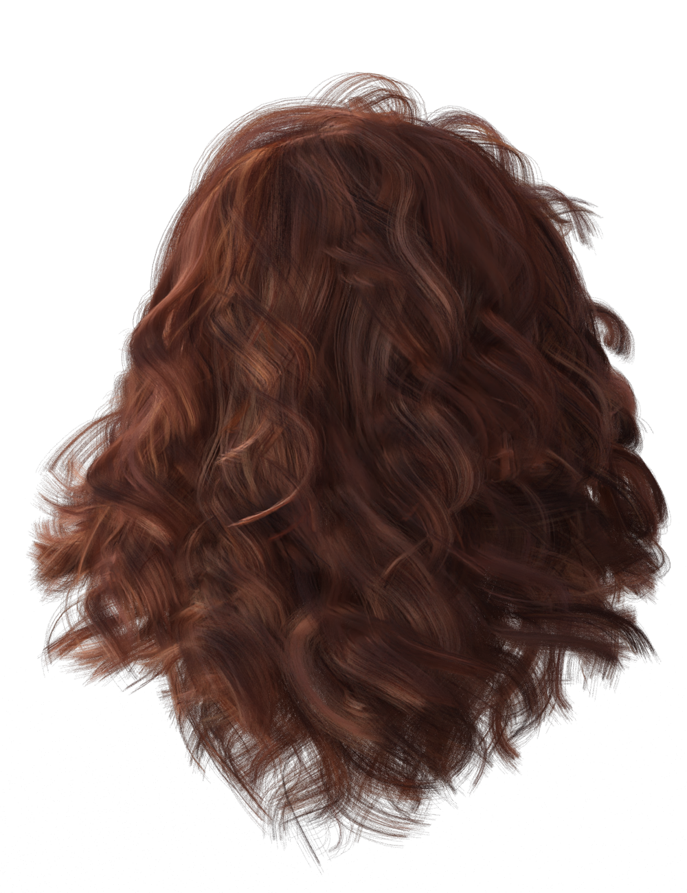

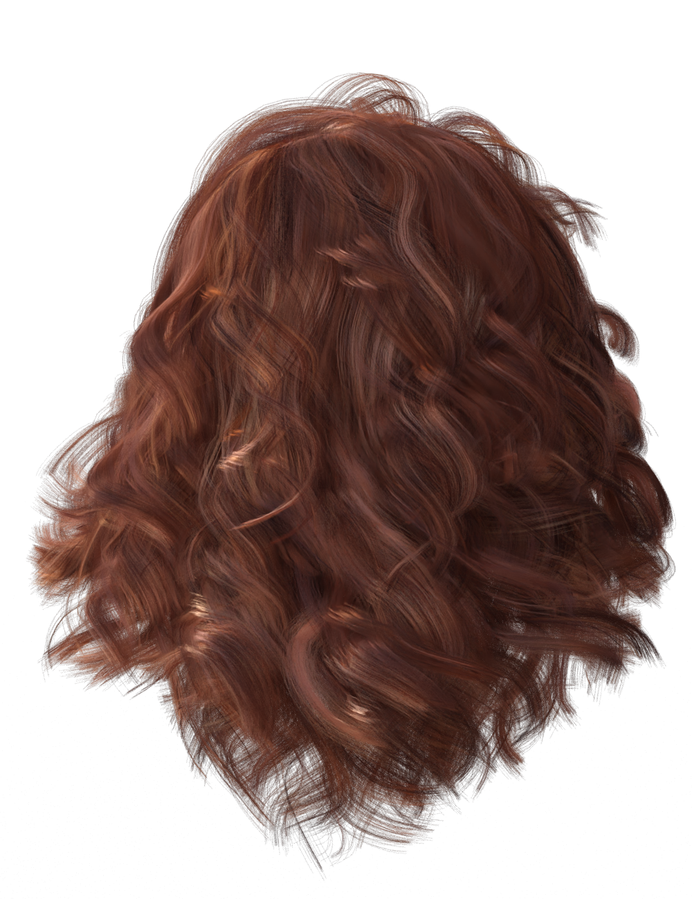

    You might try increasing the "Highlight Roughness" and lowering the "Anisotropy".
    You'll have to select the hair in the scene tab (it will have to expand the "base" and select the hair under it), then in the surfaces tab make sure the hair is selected. You can then crank Highlight Roughness up and decrease Anisotropy and that should make the hair look lighter.
    Here's the Soft Curls hair with Real Hair Shaders Deep Red. The first image is the default settings for the shader. The second image is with the Highlight Roughness all the way up to 1 and the Anisotropy lowered to .50.
    1000 x 1300 - 1M
    Soft Curls Hair w Real Hair Shader Deep Red - Highlight Rouphness 1 Anisotropy point 5.png
    1000 x 1300 - 1M
