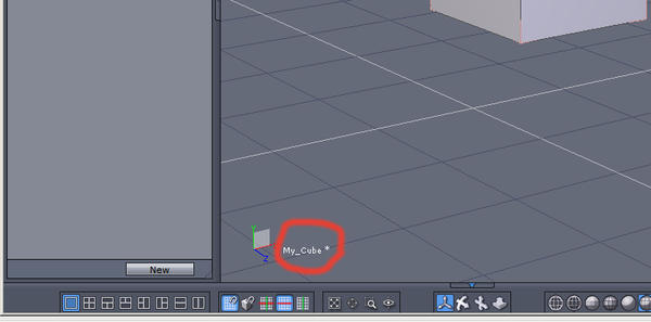

Still, I had a look at the filename preference and I have that checked, but for some reason I don't see any filename near any of the viewports, nor do I see a save number. Maybe when I rearranged my panels for two monitors, I accidentally closed an important one? Any chance of a screenshot showing where it's supposed to be?

The image below shows the filename My_Cube which has already been saved under that name. The asterisk to the right of the filename, shows that it has been changed in some way since it was last saved, and you could then use Incremental Save to add a number to the end of that filename, as in 'My_Cube00' Or, as I explained previously, you could do it yourself by using Save As.
