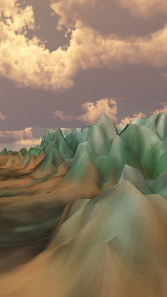

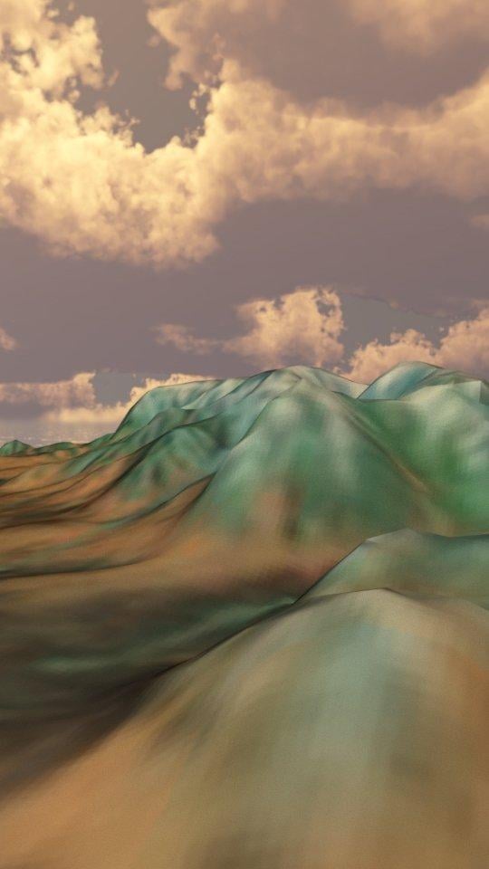

This script will create a morph that moves each vertices of a mesh to the average position of each neighboring vertex
540 x 960 - 54K
540 x 960 - 50K
540 x 960 - 82K
800 x 800 - 111K

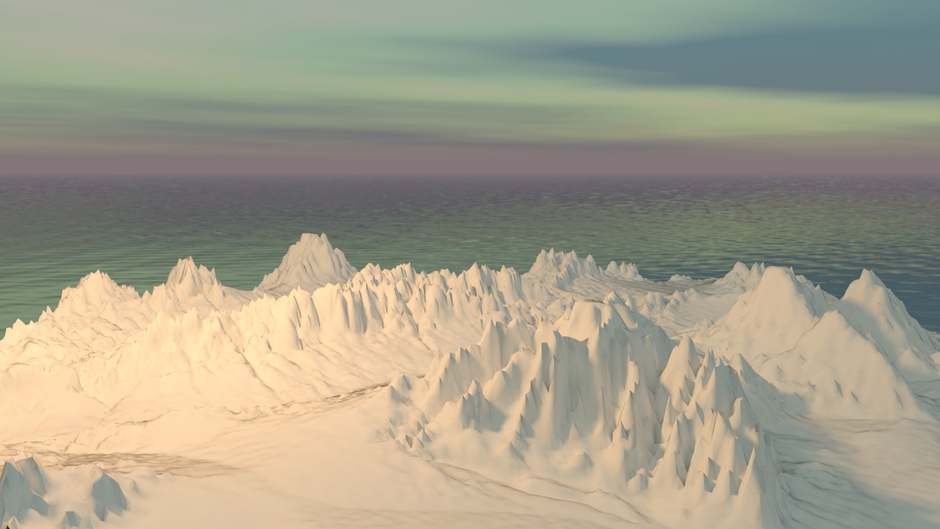

     i didnt put an undo because the script does thousands ( 180000 in the case of this terrain ) of operations and i'd worry about memory usage
    and as i was saying, turning the morph generated by the script removes the smoothing
