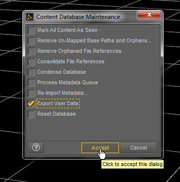

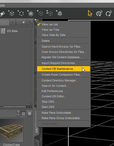

    To export user data:
    In the content pane bring up the content menu at the upper right corner of the pane and select "Content DB Maintenance .."
    In the Dialog check "Export User Data" and click accept.
    Will take a few minutes depending on how much user data you have.
