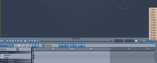

    Carrara's time code can be either FPS or SMPTE. I'm not entirely sure what you want to do? From the question I'm going to assume this is a music track?

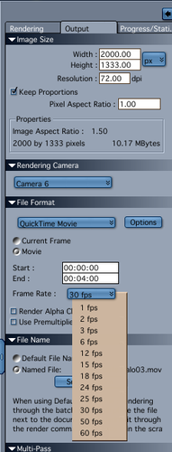

    Maybe you can choose a different fps? The most common fps for video is either 24 fps or 30 fps. There are a couple ways to set the fps for the animation and how it is displayed in the timeline/sequencer.
    As Dart says, the audio track displays a waveform, but I don't know if it will display other data like BPM. I also don't know if it's possible to compress the length of the audio file.

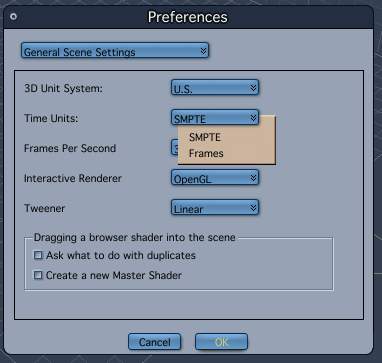

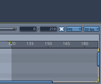

    This next bit is for people new to animation and video: I mentioned above that Carrara has the choice to display two time code schemes. One is FPS (Frames Per Second) and the other is SMPTE (can't remember the full acronym meaning). FPS is fairly straightforward. If you want a 10 second animation at 30 FPS, you'll need 300 frames, and the timeline will show it as 300 frames.
    If you're using the SMPT time code for a 10 second animation at 30 fps, it would look like 00:10:00. The first two digits would be minutes, the second two digits would be seconds and the third two digits are frames. So if you if you wanted to add a half second to the 10 second animation at 30 FPS, it would look like 00:10:15. If you changed it to 24 FPS, it would look like, 00:10:12. Either way, it's still the FPS you set that matters for the frame rate of the animation. Most video editors use the SMPTE scheme for the time, and video cameras use the SMPTE code for the embedded time code in the video they record.
    One is not really better than the other. I'm used to a pro-level video editing package, so I'm used to working with SMPTE, but ultimately in Carrara it really boils down to a display preference.

    Gah! I forgot to set the scene time range to 10 seconds, so the numbers in my description don't jibe with the screen shots. Sorry!
    To tell the truth, your nice explanation really didn't need the backup screen grabs - as cool as those are! So thanks for them anyways! So they don't jibe... big hairy deal! ;)

    In Carrara, there is a Soundtrack channel and the audio track does indeed show the sound track visuals, so it is very easy to see exactly where the beats fall. I can view the timeline of the animation either as time or frames per second. I can also adjust the frames per second in fixed increments. What I can't seem to do is adjust the frames per second in non-fixed increments which is what I believe I need to do to line it up to the music.

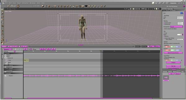

  • WendyLuvsCatzWendyLuvsCatz Posts: 41,791
    edited August 2014
    you want your figure to dance in time to the music?
    you can convert the imported aniblock
    (or however you got it into carrara, bake to studio keyframes and save animated pose also works or PFE)
    to an NLA clip
    the NLA clip can be adjusted then looped to fit the music
    select the figure and make length of animation on timeline the same as your animated pose and go to NLA tab
    create master clip
    drag the clip from clips back onto the timeline in the NLA track and make you animation as long as your music
    with clip selected drag its length to match a section of music beat then choose loop in righthand NLA editor and then drag it to loop
