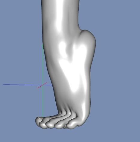

    As far as I'm aware it's not possible, I can never seem to get a straight answer from anyone involving a fix for this issue. And yes in a simple sense, just rotating the normal bone would be the answer but what if you wanted to create a not so simple situation?
    For example I made a tip toe morph that properly bends the ankle to look like a natural tip toe pose.
    Looks pretty great right? So now everything's set no need for anymore work... that is... unless you wanted to "animate" this tip toe from a flatter foot...
    wanna see what it looks like at 50 percent?
    Not exactly the picture of beauty anymore is it?
    "So Nec, why don't you just bend the toes then and call it a day, blah blah blah"
    Have you guys seen the regular toe bend in daz?
    Pretty nice, if you're an ALIEN. The toe bends and well a lot of other limb and digit bends in daz leave much to be desired... so yea, there's nothing "practical" about us having to limit ourselves to those bends.
    Also all morphs have been erc freezed, the melting issue in between min and max still occurs because apparently there's no way to make the morph properly rotate on an axis in daz... I could be entirely mistaken and it just isn't common knowledge, which apologies if so. Also don't even get me started on trying to apply this morph to already bent feet...

    I suspect "the" answer is not a one post solution. Likely requires a series of morphs with controllers which include step morph activations along with the pose trigger activations. i.e. a rather complicated procedure which yes, should be doable. It is one thing to know how to do all that, and another to explain it all.
    Morphs do not rotate. the morph moves a vertex (or multiple vertices) from one coordinate point to another in linear fashion. The vertex moves along a straight line from point A to point B.
  • KainjyKainjy Posts: 913
    You must create a joint.. Morphs work in linear way. Perfect for translations but very bad for rotations. You must rig your model and if you want use Erc to link joint rotation to a new custom parameter (grouped as a morph).
    edited July 2022
    I'm not about to start creating joints in the Genesis figures. Make the morph, make the controller. Seemed pretty simple to me - maybe I'm missing the point of what you're all finding so difficult. Try as I might, this foot did not deform into an ugly explosion of polygon goo.
