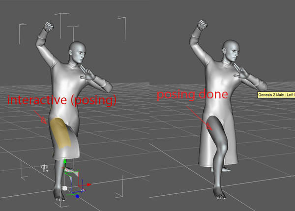

I am posing genesis 2 male with night guard tunic.(same with elven warrior tunic)
the tunic moves with the figure great when i interactive posing the figure,
when i stop posing the figure the tunics arms and tors follows ok, but the lower hanging bits goes straight.
what settings am i missing to get automatic update on the tunic.
thanks

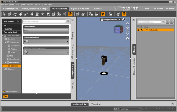

    Well to start out. There is that auto-follow thing, and the similar "collision" thing. When you select the item root in the scene tab, the settings should be in the 'Parameters" tab. (I'll update once I start Daz Studio).
    There may also be some pose morph sliders as well, That is not guaranteed for all clothing items.
    If your really lucky, they'll be some bones in the skirt/loin-cloth to let you place the thing exactly where you want it to be.
    (edit)
    I don't have that item your asking about, and the one I have for the troll is somewhat lacking.
    1256 x 800 - 69K

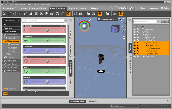

    Now the Item for the troll (came with Michal 5 or David 5), dose have some Extra pose Bones. There all highlighted in my screen-cap (Scene tab), so you can easily see where they are.
    If you select one of them at a time, then use the XYZ rotations in the "Parameters" tab to position the cloth where it needs to be.
    NOTE; Not All Clothing comes with such features, and you may be stuck with forcing the legs and whatnot in that tree to fake it, choosing the camera angle carefully as well.
    1256 x 800 - 98K

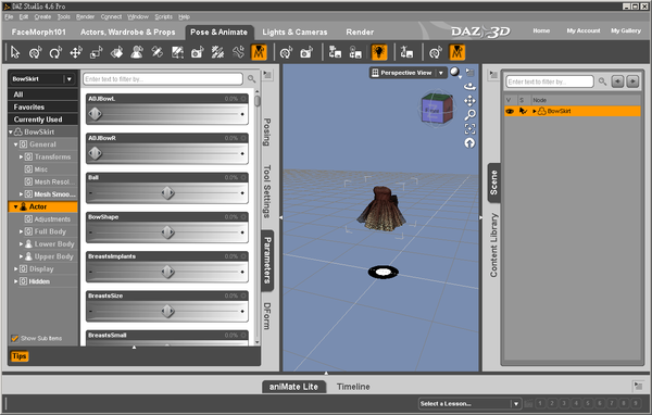

    Pose Morphs, or "Actor" sliders. Same as above, except there in the "Actor" thing, instead of 'Transit'.
    The types and even the presents of the morph is dependent on what the item was made with. The Troll loin cloth had none, so I pulled up a skirt that did have them to show where the settings are.
    Select the Item-root in the scene tab, then go over to the 'Parameters' tab, as is in my screen cap. Again, the 'Actor' may not be there for all clothing items.
    1256 x 800 - 97K
  • alex_sculptalex_sculpt Posts: 0
    thanks zarcondeegrissom
    the tunic moves fine with the legs when i pose the figure (pose in parameters or hold down my left mouse button and pose ex. leg ,when i let go of mouse button or parameter the lower part of tunic goes back to straight mood. so i think i am missing a check box or setting that keeps the tunic in pose when i finish posing (when interactive mood is not displayed).
    thanks
    Yea, that sounds like a side effect of "Smoothing" or 'Auto follow'. Chances are if you turn them off, the tunic wont fit the figure correctly elsewhere. It's a look around, and try different poses.
    You can pose the legs differently, in the tunic tree in the scene tab. If that helps.
    edited August 2014
    Everything follows fine (arms and lower parts) when interactive posing.
    not doing anything in view and the lower parts moves back to hip and hangs.
    all morphs for the tunic works fine and shows on screen but the lower parts only sticks to legs when interactive posing the figure.
    I will trying more buttons and settings.
    I guess its a really newbie settings mistake.
    thanks
    862 x 617 - 191K
    Post edited by alex_sculpt on

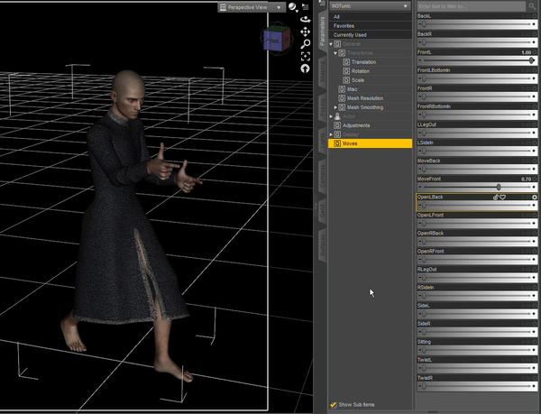

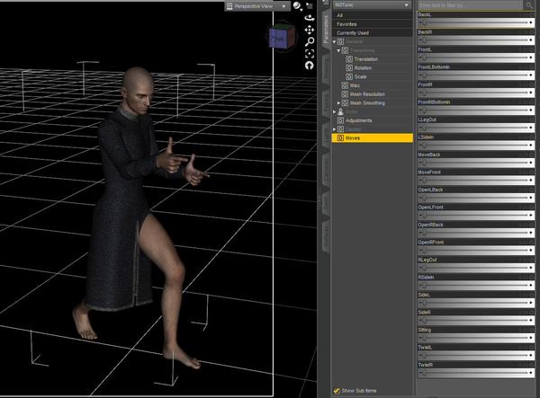

  • mark128mark128 Posts: 1,033
    The Night Guard Tunic has some move morphs. I tried a pose similar to yours and with some experimentation I was able to find a couple of morphs that fixed it with the pose I was using.
    1196 x 915 - 167K
    1232 x 909 - 168K
