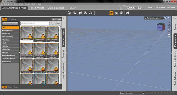

I have switched daz studio 4.6 64 bit to 32 bit because of my photoshop cs6 which is 32bit. After i uninstall the 64 bit version of daz studio and install the 32 bit version. Now all contents is showing as missed. I have tried uninstall the whole content and daz studio and reinstall the whole thing all over again and the contents is still showing as missed.
Where did i went wrong here? Or it is just the 32 bit thing that have tiny bit problem? I used the install manager.

    When you first install DS it points to a different location for content than the Install manager.
    (that's to make sure DIM does not overwrite anything)
    Check that DS is looking at the same place that DIM uses.
    p.s. There was no need to uninstall, the 32bit and 64bit versions can live side by side. :-)
    Yes, as prixat says, go to Edit > Preferences Content Library > Content Directory Manager, and make sure that your library is listed as BOTH DAZ Studio Formats and Poser Formats there.
    Let us know if that works OK.

    @ JimmyC_2009, I checked that and there are daz studio and poser formats there. They are set to C:/User/D0102/Documents/DAZ 3D/Studio/My Library. But the funny thing is that folder doesn't exist! I have tried set it to C:/User/D0102/Documents/My DAZ 3D Library. That where all contents is currently at and it doesn't work or recognize them.

    @ JimmyC_2009, I checked that and there are daz studio and poser formats there. They are set to C:/User/D0102/Documents/DAZ 3D/Studio/My Library. But the funny thing is that folder doesn’t exist! I have tried set it to C:/User/D0102/Documents/My DAZ 3D Library. That where all contents is currently at and it doesn’t work or recognize them.
    If C:/User/D0102/Documents/My DAZ 3D Library is where your content is installed to, and you have that path listed as both DAZ Studio and Poser Formats, then it really should work correctly. You may need to close DAZ Studio, and re-open it again, if you still can't see the content in the Content Library pane, then can you please post a screenshot of the Content Library so that I can see what you are seeing?
    By default, the DIM (DAZ Install Manager) installs all of it's content to C:\Users\Public\Documents\My DAZ 3D Library, and unless you changed that, it will all be in there.
