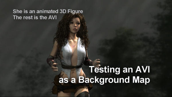

    So, perhaps I'm not understanding your issue. I've conducted a quick test, and uploaded the result to YouTube: AVI in Background Test
    As the video states: This AVI is meant to be in the Backdrop settings, not the Background, so it's quite out of scale. But it is an Full Frames avi, which is how I always save avi files that I need to process further. I never compress them to a codec until the final production phase, which is why I've taken it upon myself to start a Hard Drive collection! :)
