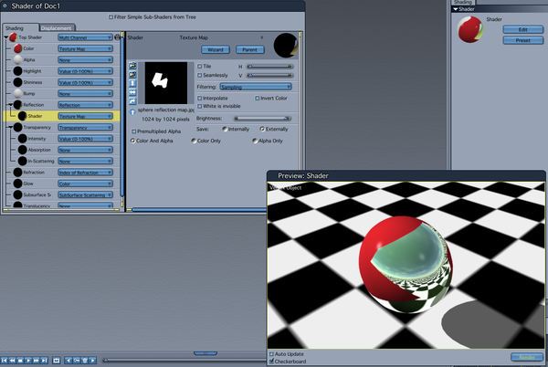

    So you want just the UV mapped image to be reflective?
    You may not be able to share the actual image due to contractual obligations, but can you post a reference image from the web somewhere that shows more specifically what you want? Maybe a simple mock-up?
    My first thought is that you could put an image map in the reflection channel to define what reflects and what doesn't. If the whole label is supposed to be equally reflective, trace the shape of the label that you're using in your image editor and make it white with the non-reflective area black. I could be have it backwards, so if I do, there's an Invert Color checkbox that you can enable near the image map thumbnail.

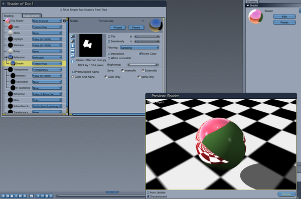

    So here's a simple UV mapped vertex sphere. I saved out the template so I could do a basic paint job in PS, although you could use the 3D paint tool in Carrara for this as well.
    I created a color map and loaded it into the color channel. I also created a black and white map and loaded it into the reflection channel. The shape is white and reflects. I inverted in one of my examples to show how it looked.
