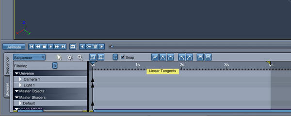

  • Steve KSteve K Posts: 3,535
    timandjan said:
    Hi
    I am working outside of the animation blocks I was using to set up some preliminary positioning and motion.
    I don't understand why something that I have completed seems to get changed by something I do further down the line in the sequencer. ...
    I recall a similar experience that was due, I think, to the type of tangents used in Carrara's sequencer. I don't remember the details, but the spline tangents might cause a change to earlier frames to "smooth out" the approach to the key frame. Or something. You might try the linear tangents.
