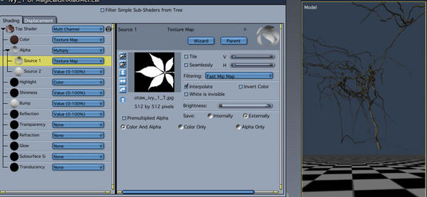

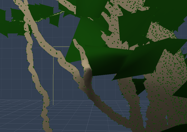

See the attachments for what I'm doing.
The alpha maps look good, and render good in DazStudio, and in the Carrara Alpha preview, but in the image render they just set the object fully transparent...

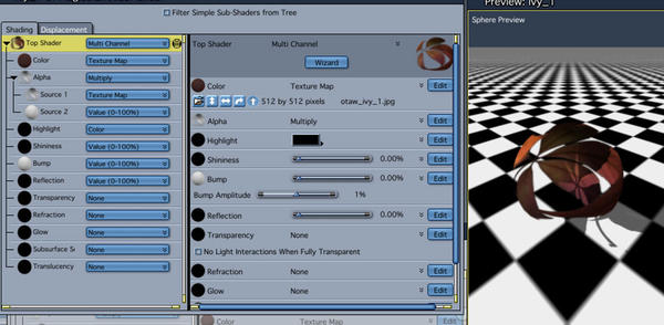

    To begin with, try dragging Source 1 of the Alpha channel (left side of the shader window) directly onto the Alpha channel.
    When you're done, the Alpha channel should be set to "Texture Map"
    See what that does for it.
    My thought that it is the multiply function in the Alpha channel. Try dragging the image map channel in the multiplier up, and dropping it on the multiplier. This will remove the multiplier and leave the image map as the only thing in the Alpha channel.
    D/S, Poser and Carrara each use different shader systems and render engines, so even though they're generally compatible, there are sometimes little hiccups or mis-translations between them. My guess is that this is an example of that.

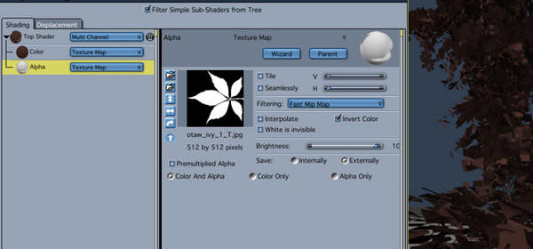

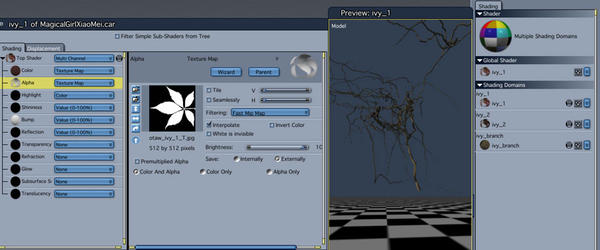

    Tried that, but it doesn't seem to improve things.
    The alpha map is a jpg - could that be it? Should I edit it in photoshop into some other image format?
    937 x 390 - 65K

    A long shot, but what if you click the Invert Color checkbox? It may have been why the multiplier was in there. The PA may have made his map differently than normal, and corrected for it in D/S, but it may translate wrong to Carrara. It's just a theory though.

    When I click invert it renders the whole thing as solid squares.
    - Curiously, the texture also vanishes. Only the color shows:

    Somehow you clicked the Filter Simple Sub-Shaders from Tree checkbox at the top of the shader window.
    My next suggestion is to un-check the invert box, and maybe do a test render. If you're using GI, then turn it off temporarily. Make sure that Light through Transparency is enabled. When you're ready for the final render, if you're using GI make sure the Light through Transparency option is turned on in both the standard renderer settings at the top of the screen and in the GI section.

    The alpha map is a black and white image, so it shouldn't matter what the format is. There may be another way to get the alpha if the alpha channel continues to cause problems. You could edit the image map in the color channel in PS. Basically make it layer and delete or erase everything except the leaf. You should be left with only the leaf. Save As in a format that supports alphas, such as .tiff, .png or Photoshop. Load the edited map into the color channel. The alpha will be respected. You can leave the actual alpha channel in the shader empty.

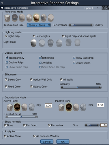

    The reason I wanted to see an actual test render is because the Texture Room is sort of an OpenGL thumbnail view. It would maybe be a long shot, but perhaps the complexity of the model along with the alphas is causing it to not display properly. There is also one more possibility and that is perhaps the Normals are reversed on the leaves. I've had the issue before in the Texture Room preview. They rendered fine in the render room. My suspicion at the time was that Carrara only displayed the front facing facets in the OpenGL preview to save on resources. Again, it's just a theory. I nothing else works, then I can tell you how to check the Normals. It's a simple process.

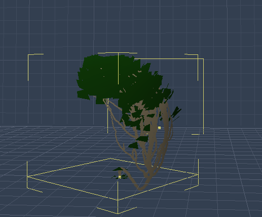

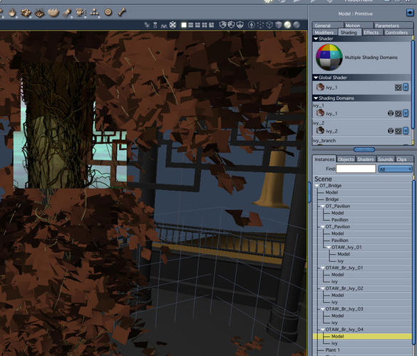

    Do you have a light in that scene? All I'm seeing in the scene tab is the ivy stuff. It'll show up in working view, but not in a render.
    I was actually just going to recommend checking that the lights in the scene are not excluding the ivy. Also check render settings, though I cannot think, off hand, how any of that would make your objects invisible.
    Go back to the Multi-Channel shader that you had in the first screenshot, but drag the texture map (source 1) directly onto the alpha channel.
    Keep the transparency channel at "None" as in the screenshot. Same shader as screenshot, but without the Source 2 in the alpha.

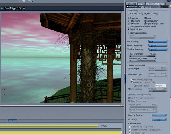

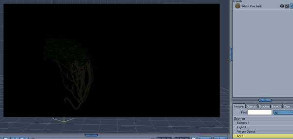

    Here's a test render. I had global illumination off.
    746 x 458 - 69K
    910 x 714 - 123K

    Just a thought...how are you loading the ivy into the scene?
    Some apps that make leaves - Xfrog and IvyGen, for instance, need you to import using facet meshes instead of the default vertex primatives, otherwise the leaves are invisible. This may be the case here.

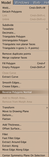

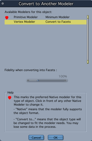

    I know there was an issue with Ivy Generator on Macs reversing the Normals. If the person that made this set was on a Mac and used Ivy Generator to get the ivy, then perhaps the Normals are reversed? I have just used Fenric's plugin and the Normals were indeed reversed for me. I had to convert the ivy from a primitive to a vertex model to reverse the Normals.

    If the Normals are going in the correct direction on one part of the model, but the wrong way on another part, reversing them will make them all go in the same direction over the entire model. If it ends up they're all going the wrong way, then use the Reverse Normal command again. Generally speaking, when the Normals are going the correct way, the little lines will be displayed as pointing out.
    Regarding the screen shots: The Ivy has clearly been converted to a vertex object in the finished product. I only included the screen shot of the conversion dialogue to show the steps I took to get to the vertex model point and to show that the Normals were reversed upon conversion.

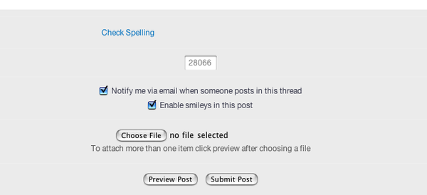

    (There's not ability to show images in the forum without attaching them? no IMG tag?)

    You can attach images to forum posts, but not embed them. The maximum dimensions are 2000 X 2000 pixels and the forum will accept .gif. jpg and .png. The maximum file size per attached items is pretty generous as well. It will be split between your attachments. I think it's around 9 or 10 MB. To attach more than one image, after you have selected your first image, press the Preview Post button. If the file is large, it may take a moment to refresh. Use the Choose File button to browse to another image, and hit the Preview Post button again. You can attach five images per post.
