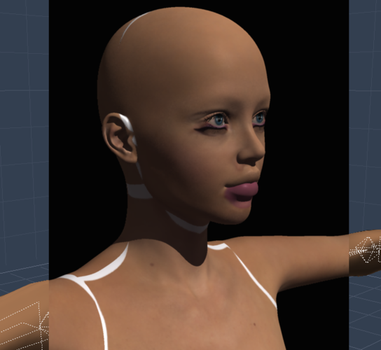

So I'm trying to use some of my downloaded content for a change (always a recipe for disaster, since I end up wasting hours that I don't have just going round and round in circles, getting nowhere!), and build that explosion scene I talked about before.
Trying to get my characters sorted. First off... Stephanie 6. I loaded up the Taylor preset that comes as part of the bundle. Tweaked the morphs to how I wanted it, and then tried applying Ringo's S6 shader.
Oh woe!
Now I'm probably doing something wrong, since, as is typical with anything from the Daz store, there are no instructions (grrr, but that's a side issue), and consequently I have no real idea what I'm doing.
So, how do I fix it?
Thx :)
702 x 645 - 264K

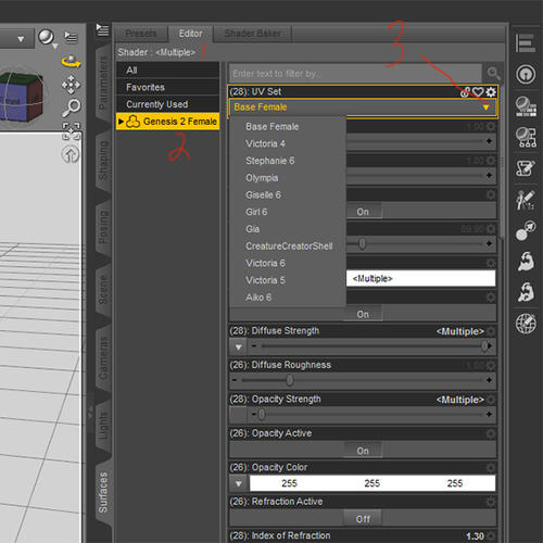

    There should be a UV set option in the Surfaces pane. This is how you do it in DS apparently
  • frank0314frank0314 Posts: 15,116
    That's where you change it at.
    600 x 600 - 131K

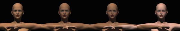

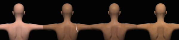

    Okay, so I loaded up S6 Taylor in Studio and changed the UV preset (it was Victoria 5 ???) , then saved it out as a character preset, which I loaded into Carrara and applied the Ringo shader. It was better, but there are still clear seam lines showing, particularly from the back.
    I've lined up, for comparison (left to right): Stephanie 6 (default shader), Stephanie 6 (Ringo Shader), Taylor Character Preset converted to S6 UV (Ringo shader "same master"), Taylor original (default shader)
    The back view shows the seam issue much more clearly.
    1147 x 258 - 163K
    1721 x 305 - 276K

    This is a long shot, but are the texture maps set to fast mipmap or sampling? Fast mipmap sometimes leaves seams where the textures "join".

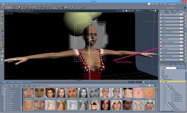

    3) Select "Actor" in the Instances tab and on upper Tabs select the " Parameters" tab. Scroll all the way down until you find "Taylor" figure slider and slide it all the way to 1.00. Stephanie 6 is now Taylor you are done.
    P.S.
    I should also mention that you can slide the Stephanie 6 slider back down to zero now.
    See the attached screen capture and let me know if this help you.
    1680 x 1010 - 870K
