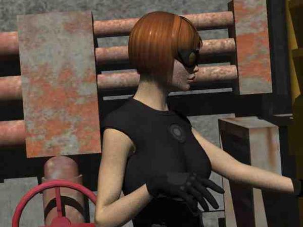

tiggerspringstiggersprings Posts: 304
Okay, this seems to be a problem... The Genesis clothing I have isn't even fitting the unmorphed base figures well once "Fit-To" and posed. But, there seem to be no parameters (or sub parameters for different body groups) in Genesis clothing for adjustments. Here's Space Age Behemoth fit to Genesis 1 female (she is morphed a bit). When I select the clothing actor, there are no sub-parameters to adjust for the chest poke-through on the main suit... This isn't the only clothing I've seen the lack of parameters on... Am I doing something wrong?

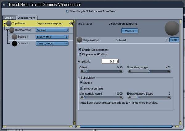

    One way to fix the problem is to open the offending clothing item in the modeling room (select it in the scene/intstances), then open the modeling room (wrench Icon), select the vertices in that area and pull them out slightly until the poke through is gone. This is fairly easy if your comfortable moving vertices around, otherwise, it's a bit daunting (but a great skill to learn).

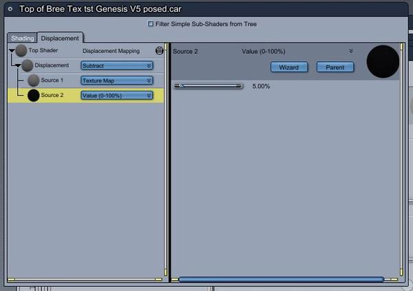

    The other option, that should work on this bit of clothing, is to use a minor bit of displacement in the shader. To do this, select the "actor" of the bit of clothing you want to fix, then open the material room by clicking on the paintbrush icon - you should now have the shaders for the clothing item available under shading domains on the right side of the screen (unless it only has one shading domain, then the shader window you want will already be open). Double click on the shader that covers the area you want to fix, and Carrara will open that shader for editing. Now click on the displacement tab, Click on the blue button titled "none" and select operators>subtract (see last image below). Now set up the displacement like shown in the next two images, using the big gray square image below as the texture map (just right click and download someplace you will be able to find it and easily use it again if needed). This "should" remove the poke through. You can experiment with the offset and source 2 values the get a better fit (in this case, increasing the offset value will reduce the displacement away from the base figure, reducing the value will "push" it farther away from the figure).
    I'm sure this was all just about as clear as mud, hopefully you'll be able to figure out my arcane instructions without your head (or figures cloths) exploding.

    I was just working with the same displacement setup on some other items, and It didn't seem to work as expected, so I'm not sure it's worth you investing a lot of time (or any) on the displacement method. The results seem rather unpredictable (though I could be doing something totally wrong).

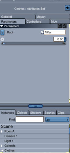

    What does that little pulldown menu next to the word, Root show? Any options there?

    Well, here's something a bit interesting. After reopening the scene and selecting the actor, I can see the paramaters. So I was able to fix the poke-through with dials this time... Odd..
    It's a good thing, because materials and the modeler are still beyond me yet. Really not getting along with this program, at all. :gulp all. I don't think I'll be putting much more time and effort into it. I'll give it two more weeks, at best. :down:
