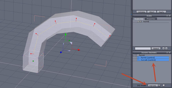

    Hi,
    I'm having issues with hexagon. the problem is that i'm unable to select multiple faces at one time, while using the sweep surface tool. Also, within my created object there is these red lines with little squares on them. I 'm able to select 2 faces on the original primitive, but when i go to use the sweep surface tool it automatically switches to the auto select tool. Which i still just want to use the select face tool. As i have mentioned before being able to select faces on the original primitive, but not able to select faces on the parts that were extended from the square primitive by way of using the sweep surface tool. Just wanted to say that, in the beginning of using this Program, i didn't have these issues. anyone can help me out?
    You must of changed "Dynamic Geometry" to "Full DG". (small window bottom right of UI. See attached pic).
    Dynamic Geometry is a powerfull feature, but not sure if there are any tutorials about it.
    I will try and find some time to make a post showing how to use it.
    For now, I would suggest you change the DG back to "Restricted DG" or "No DG"
    (Note: The little red squares, those are used to scale the sections of the sweep. You need to use the "Utilities > Stretch" and LMB+drag on them to scale the sections.)
    Pic showing Cube with top face "Sweep surface" with "Full DG" enabled.
    1094 x 559 - 97K
    Post edited by stem_athome on

  • joshuabouillion87joshuabouillion87 Posts: 99
    Been a while since I've posted about that particular issue, but that would be the the little red markers that I talking about. I ended up taking some advice about resetting the program. If that happens again ill definatly take your advice. Thanks a bunch!
  • stem_athomestem_athome Posts: 526
    Resetting the program(preferancies) will reset the DG to "Restricted. So yes, it will stop DG being created on those sweeps.
    Sorry, I did not see/realize the first post was made back in Aug. Better late than never I suppose.
